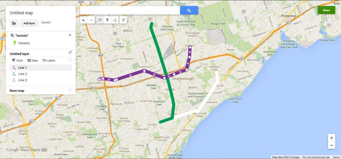

This is a new idea I just put together. I have sheppard going down to STC, but turning north and going to Steeles. I also have the Bloor Line going to Malvern Town Centre and Cenntenial College. I brought Eglinton East to UTSC.
Reason why I have changed the order of the subway is that I believe this serves all of scarborough effectively. I think Turning Sheppard north on McCowan Would bring great ridership to the subway. Ending at steeles helps a busy bus routes. Bloor helps serve some very underserved areas. And brings rapid transit to Northest Scarborough. I brought Eglinton East to UTSC. There would be no transfer at Kennedy which would would guarantee high ridership. I have a transfer at STC because I think that would help bring people there.
Thoughts.

For this, I would think that having the purple continue east to Malvern and the B-D continue north to Steeles would be a better option. It seems odd that Sheppard dips down south and immediately turns back north again.
If we can get GO to co-operate, then I would have frequent service on the Markham GO line, and that is too close to the McCowan portion of the line. The big problem is that we do not have a clear indication of how the GO lines can help rapid transit in Toronto. For all the advertising that Metrolinx does, I still have no idea what they are planning and when it will be implemented.
Very astute. I think until hourly service gets implemeted on GO transit we won't know if eastern Scarborough acutally needs this.

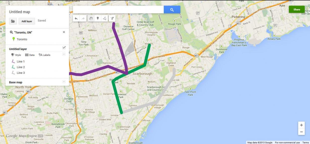

Minor Change. This is what you were describing BurlOak?

At least this ought to increase ridership on the Sheppard subway substantially. There is so little development along the parts of Sheppard not covered by this version of the Sheppard subway that the #85 bus ought to handle the remaining Sheppard demand perfectly well.
I somehow doubt the BD extension is needed though. It is too close to the Stouffville GO line, and south of Ellesmere there is hardly any new development. I suppose there is a fair amount of development around Finch/McCowan though, but it seems strange building subways to both the CN and CP rail yards in the GTA.

This version is definitely more practical than the first. Maybe, taking BD to Steels is going too far; getting to Sheppard or at most to Finch may be enough. Relief of the Steeles East and Finch East routes can be more effective with the DRL - Don Mills subway line, as it will intercept Finch and Steeles where the buses are actually full.
As for the Sheppard line, extending it to Malvern makes sense; but I am not sure if it should be a full-fledged subway, or some kind of a high-floor mini-metro, which can use the existing subway tunnel but is capable of making sharper turns. The latter may be cheaper if a long line is envisioned.

You think Steeles ridership drops off after McCowan or probably Kennedy eh? Maybe so. I think Finch would be fair. Sheppard? Here's what I think? Why not used the RT cars/Sky train. People would hardly know the difference and it would be easier to extend or bring above ground. It's not LRT either for the whiners. Win Win. Also I don't like the McCowan Road alignment for the BD. The subway can go in the RT corridor. I also think Eglinton can either be LRT or Subway, but the transfer at Kennedy has to go.

This is what I envisioned with my plan. If not all the way to Steeles, then there's a strong case for letting the subway intercept the Finch corridor, with Woodside Square and condominiums a destination in their own right that'll justify such an extension. You could even build it further to the high-density cluster at Alton Towers (500 metres south of Steeles). This would involve short-turning some 53 Steeles East bus trips at McCowan but a worthwhile detour.
As per my map, the sharpest curve occurs in Malvern when turning onto Neilson but there are tighter curves already functional in the system (Museum-St George and King-Union). And the cost of a grade-separated line through Scarborough to Morningside Heights will be expensive no matter which technology is chosen. If the Sheppard extension is largely elevated, then I don't see why not continuing it as a subway to provide a one-seat ride right across the city.

The transition would occur east of Kennedy, elevated adjacent the Stoufville then connect to the SRT corridor and follow the same elevated alignment through to Morningide Hts. Only a minor segment between Milner and Washburn would be tunneled.
The Museum-St George and King-Union curves are functional, but TTC hates them and would not build anything similar these days. Such tight curves are not good for wheels and tracks, and are too noisy for riders. That applies to standard size subways, but a mini metro might be able to handle tighter curves.
On your map, there are at least 4 (maybe, even 6) rather tight curves on the Sheppard line.
For a one-seat ride across the north of the city, converting the existing Sheppard subway to some kind of high-floor mini metro might actually be the best bet if that technology is cheaper to extend. If it is extended as subway, it will probably never go east of STC because of the construction costs. In the west end, the probability of going past Downsview depends on the construction costs, too.
I used to be in favor of a subway / LRT combo solution; extending the subway to Agincourt and building LRT east of that point. I personally do not mind transfers, but it appears to be a big issue for many people. If so, maybe we should think how to eliminate that transfer. But if the subway is extended, my concern is that it will never go past STC due to the cost. On the other hand, converting the existing subway to low-floor LRT is costly, and is guaranteed to anger many existing riders. Therefore, I am trying to think outside the box, although not sure if the mini metro option is viable in this case.
