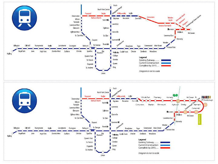

Whether the Sheppard line of Transit City goes ahead as LRT or a subway, I think the more important aspect is that it travel all the way to Markham Rd, preferably Morningside Rd, before looping back to Scarborough Town Centre. Instead of just linking another mall, the city has the opportunity to connect two important educational institutions in the Scarborough campus of the University of Toronto and Centennial College.
I realize that transit maps do not have to represent geography, but I'll mention that UofT Scarborough is south of Ellesmere just in case. Two lines with an interchange would serve Scarborough much better than a loop.
