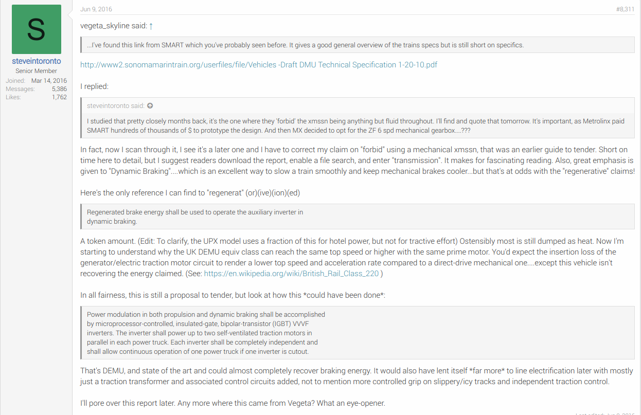

It could well have been me who posted the tech details on the ZF six speed box in this string prior.
https://urbantoronto.ca/xenforo_tes...m-s-metrolinx-mmm-group-limited.3188/page-555
Post Script: Accessing this string at the link above, almost all the reference links are now dead in that post and those following, however, I did quote sections from the now dead linked reports and manuals.
Just digging further, even some of the Wiki pages are dead, but Google cache fortunately saves the day:
