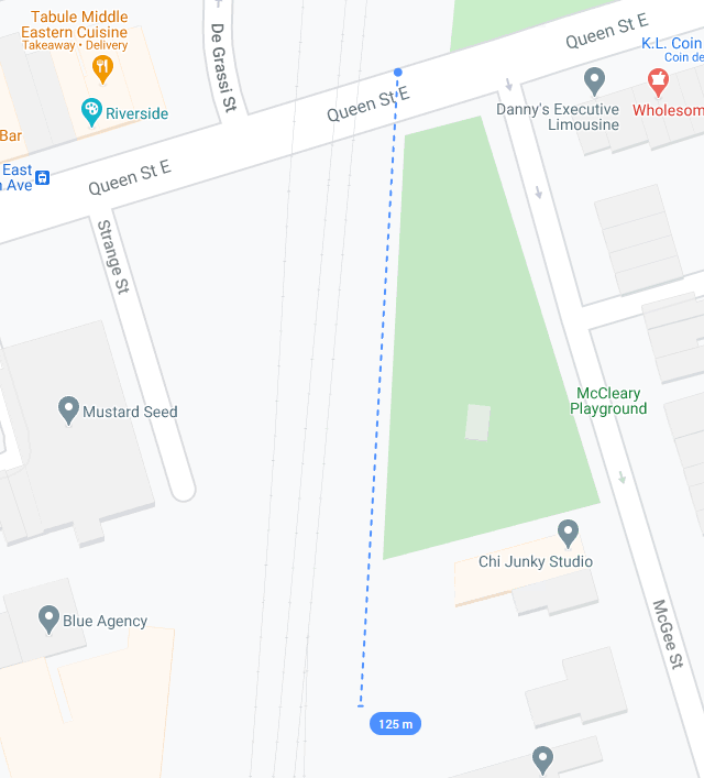

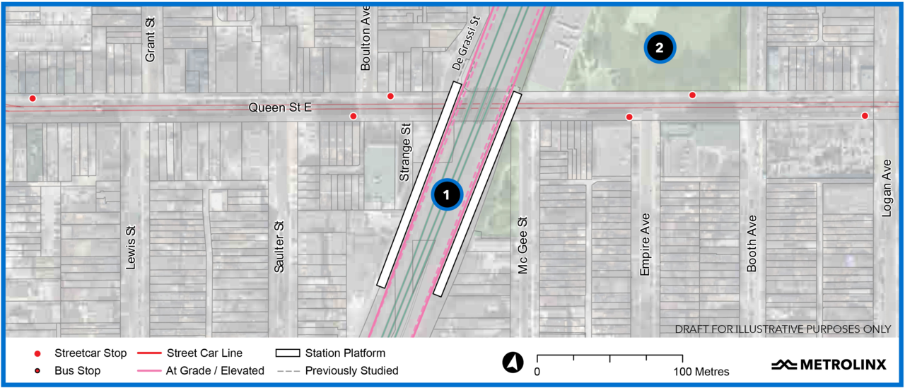

The platforms on that Leslieville close-up diagram seem a lot longer than 100m (compared to the Gerrard diagram).
I eyeballed it on a map, looks like about 125m.
My guess is that the actual stopping area for trains will be fully south of Queen Street, and the part that extends over the road will be more for pedestrian access.

Hmmm, @smallspy and @crs need to comment; but I'm looking Queen Street and have trouble reconciling the math/suggestions of Mx.
I assume a track requires 3.5M.
They appear to be suggesting they can fit six tracks + platforms with little or no land take.
When I measure across, I get ~18M in the existing corridor. I get that they will add 2 new tracks on the outside of existing, based on their description.
But if each track adds 3.5M, plus parapet wall, that's what, another 7.5M already, so you're closing in on 26M w/o platforms, and w/o stairs/elevators up/down.
If you cut down every inch of vegetation on the embankments, I still can' tsee the corridor wider than ~40M which leaves me confused about how they wouldn't eat into adjacent parks or even buildings/streets.
Is my math off?

Since the platforms will be on the outside, the encroachment could be a cantilevered platform structure over an area or building.
That makes sense - like the pedestrian overpasses at Vancouver's Commercial Broadway Station.

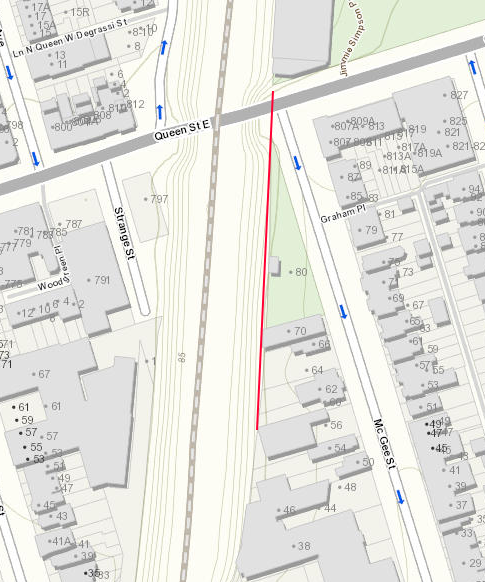

If one believes I drew this line correctly (It appeared to me that the track begins 4 lots south of McCleary Playground on McGee.
The mapping program says 146M

Metrolinx could technically just take the playground.
I strongly suspect that picture is inaccurate and needs to be republished or something. It shows the line going directly over Strange St and through the Fontbonne Ministries building.
That doesn't match this picture, which looks significantly more in line with what Metrolinx said in their blog post today.
