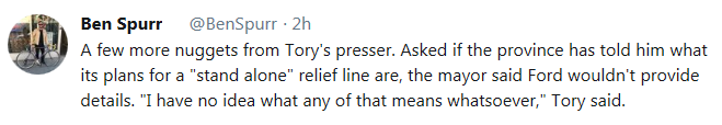

@tiffer24 : Indeed, there were hints that some somehow have overlooked, many quotes like this:
The Province wants the DRL to be completely free-standing in that it would not depend on Line 2 and the existing yard at Greenwood, but would be built completely separate from the existing subway network. Moreover, "alternate delivery methods" would be used for this project, a clear indication that this would be a privately designed, built, financed and operated line much as the Crosstown was intended to be before a deal was worked out to let the TTC drive the trains, at least for a time.
There's a number of other quotes already in the public realm that go even further. The intent is very clear, if not the details, and your Tweets buttress that.
