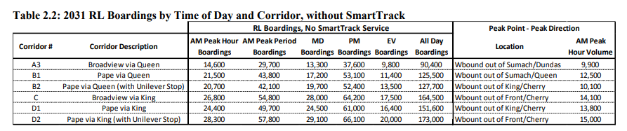

There may be many destinations in the north of downtown, but you have to trade-off against the significant number of destinations in the south of downtown. SouthCore, the Financial District, St. Lawrence Market, Distillery, etc., mean that there are more destinations south downtown than north downtown, which is why ridership projections showed greater ridership for a King DRL (173 000) than for a Queen DRL (128 000).
If the DRL is too far north from those destinations, then that means that riders will either need to walk further from the stations (reducing ridership) or will choose to stay on line 2 and transfer to line 1, reducing the "Relief" aspect.
