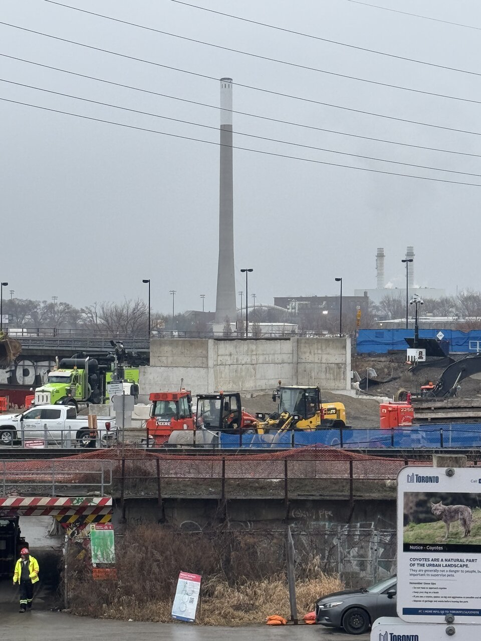

These are the supports for the bridge over the Don. Taken 18 December.
yea those on the east side have been there for awhile. Was complete like a year ago.
This is half true.
The bottom portion has been there about a year. The top half was done within the last few weeks.
