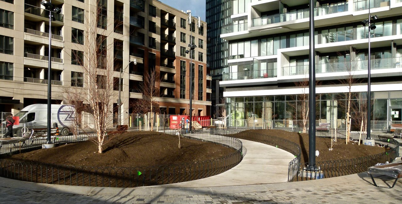

Note this little Claude Cormier park in the 88 Queen North development:
Photo Credit to forum member @skycandy
Cormier installed a little mini-fence to keep people and dogs off his garden.
Whether one uses that method, or seat walls, edges with vigorous shrubs that people just won't choose to walk through; you need to either actively discourage people walking certain ways, or make it easy for them
to walk the way they wish.
You can even do both.
The design referenced in your thread is attractive, but it needs a touch of pragmatism in that regard.
