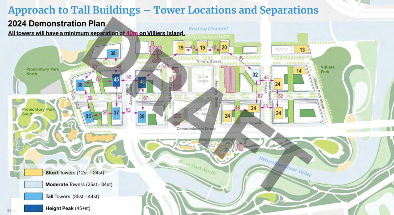

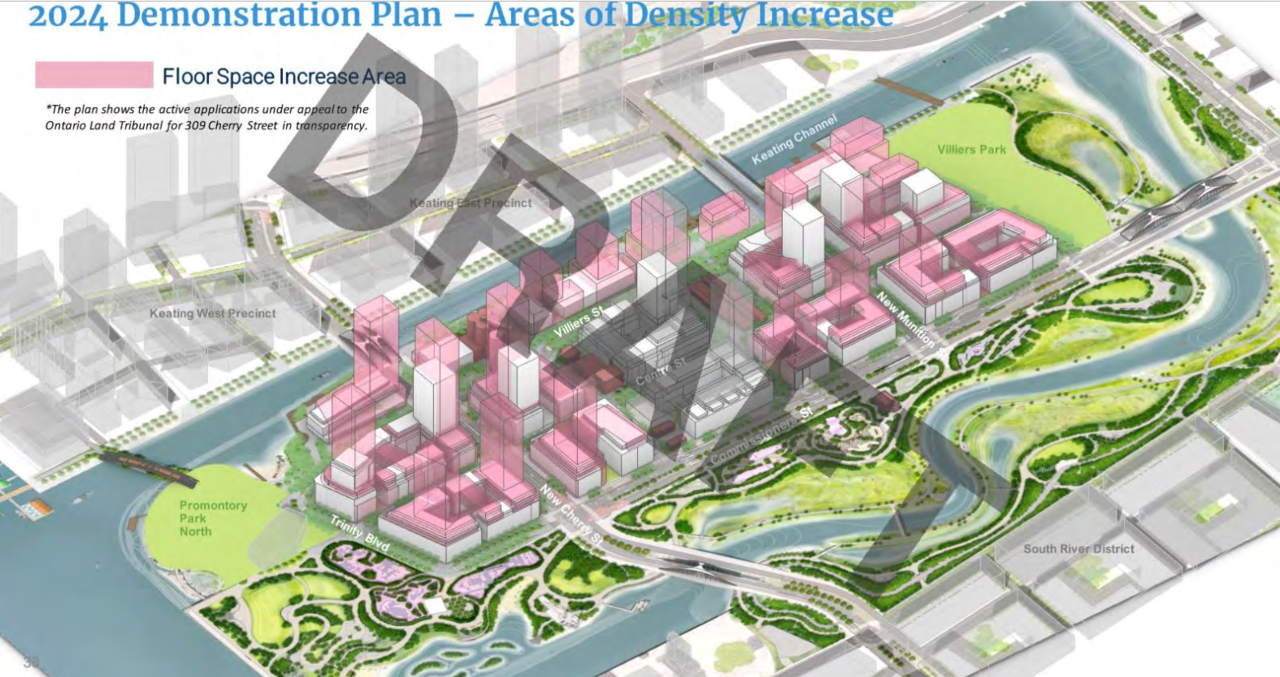

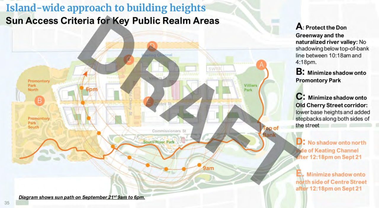

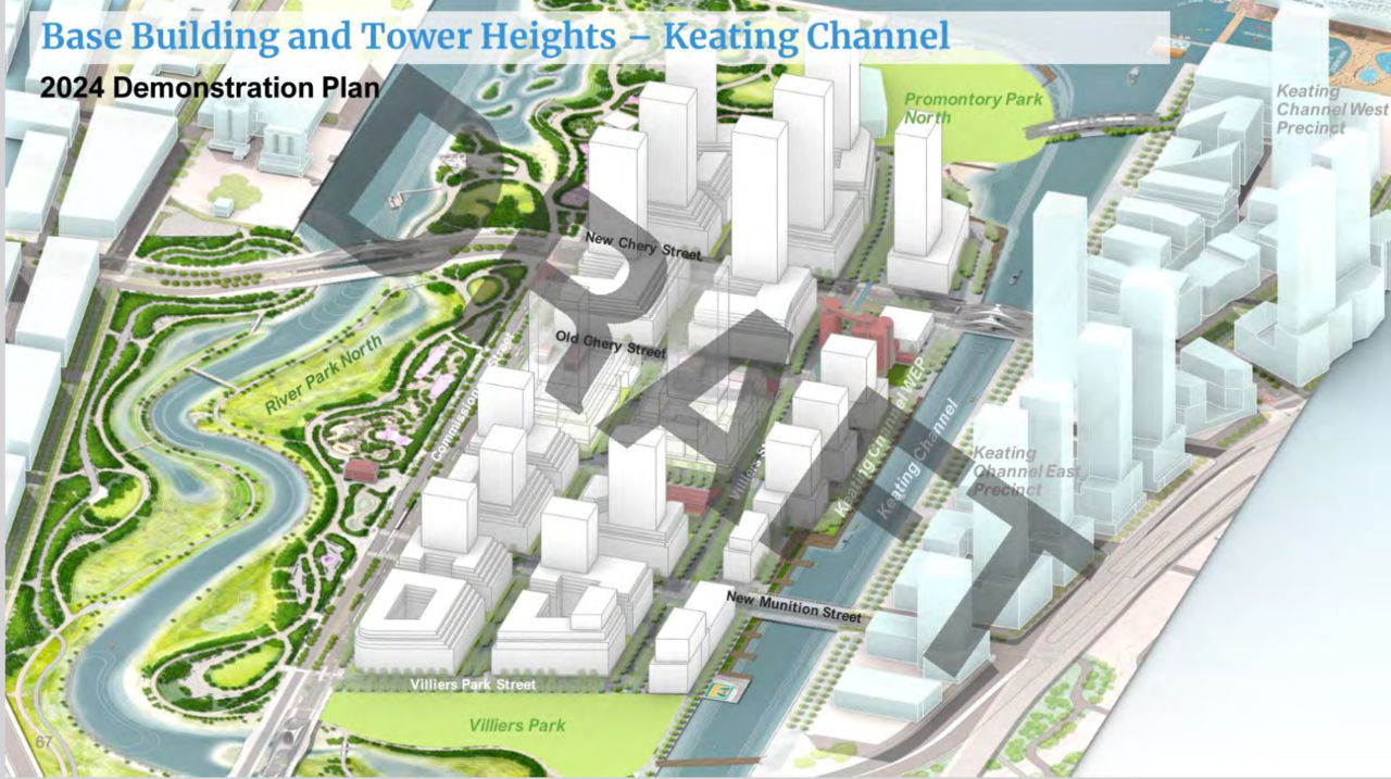

This (below) is very good work, praise-worthy. It actually tests all the different permutations of height/massing, particularly podium levels and their impacts on sun access.

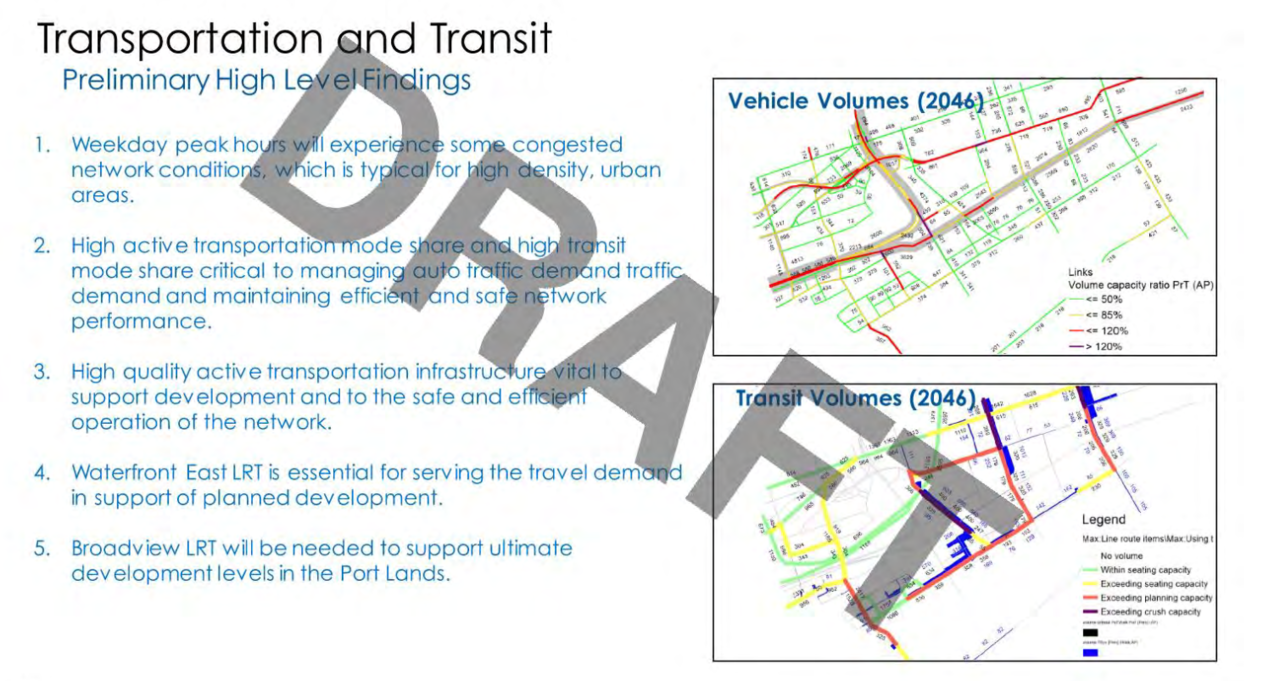

One may recall that a concern I expressed over jacking density here is that the level of planned transit would not support it: The modelling certainly points in that direction, like with the Golden Mile.
That does not mean one can't do higher density here, but there if you want higher density you must plan (and deliver) the appropriate level of transit and other supporting infrastructure.

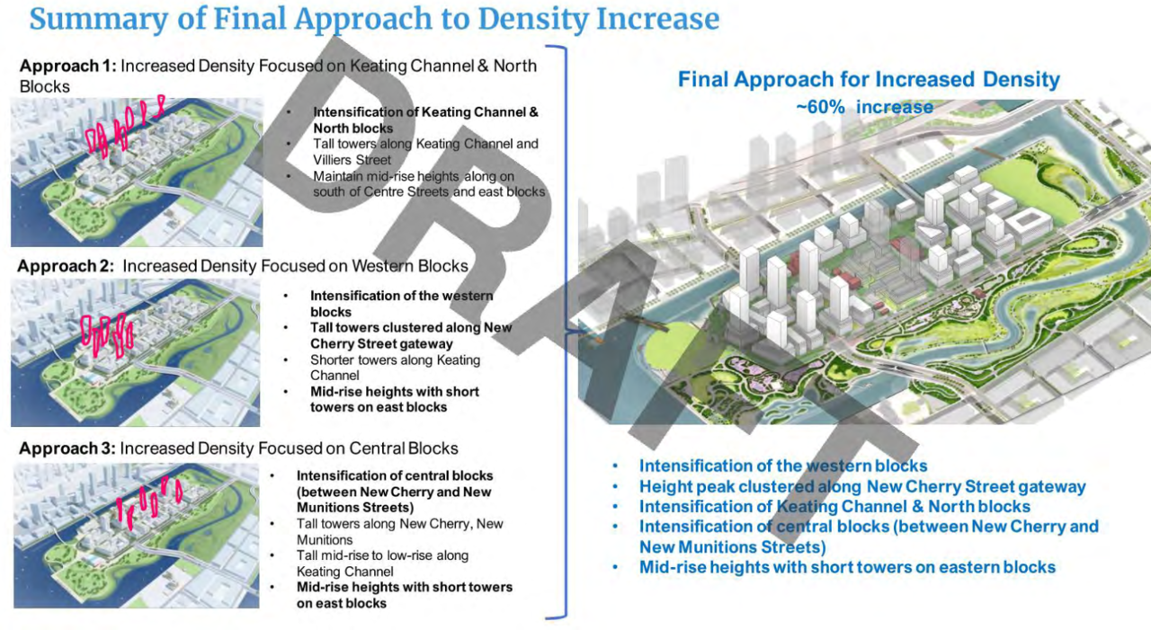

Thanks, Northern, for the update.

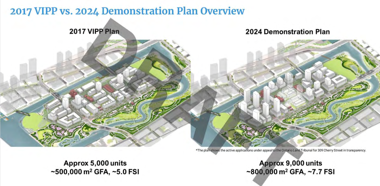

As I noted in my previous post, I supported a modest increase in density over the original proposal, and I think the newest proposal hits the sweet spot. I know there have been some rumblings on UT and social media that Villiers Island is still not dense enough, but I'm reluctant to support more density until the transit plans are officially approved.

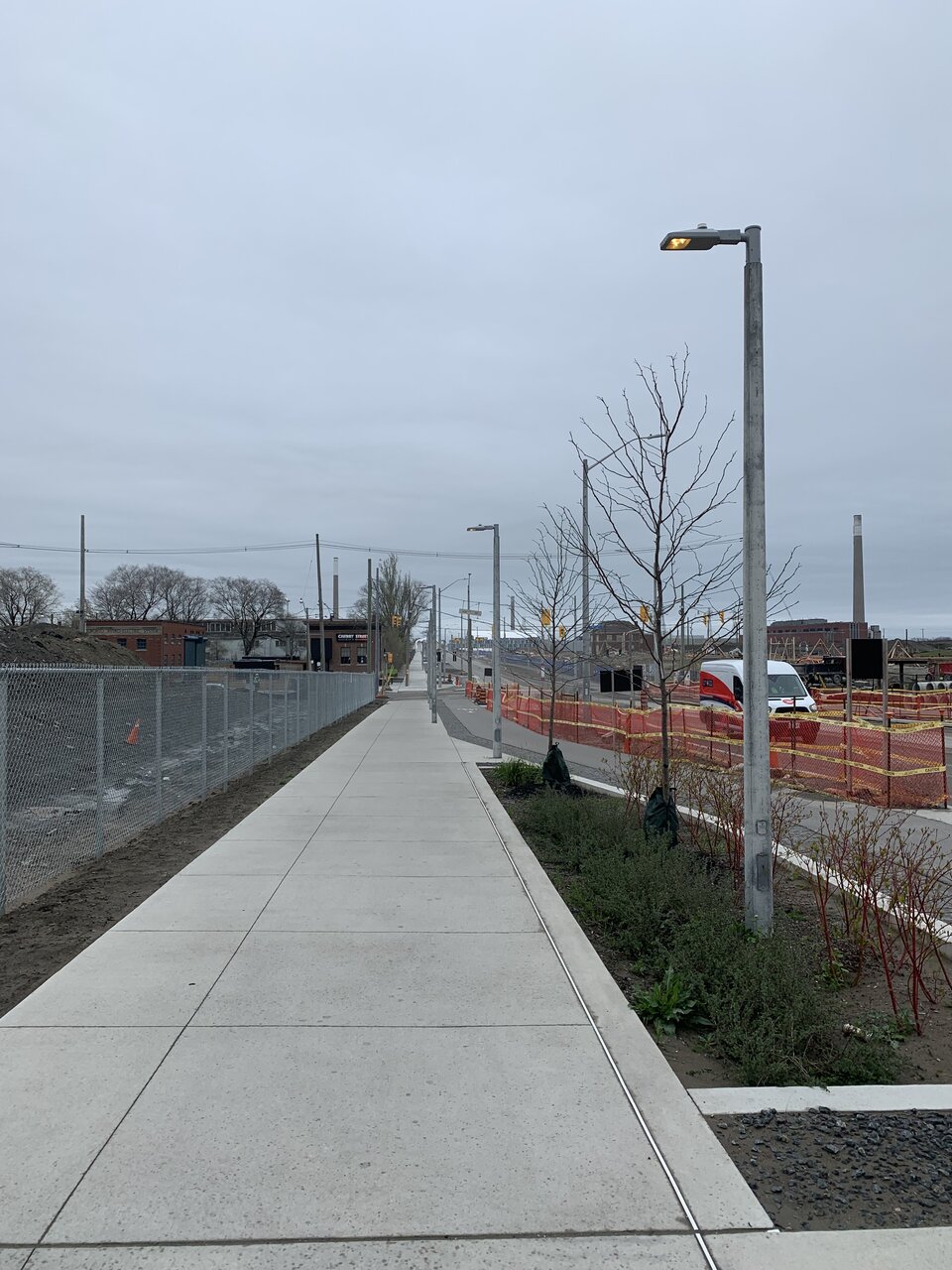

Thanks! As far as the caravans go I believe that they are owned by film studio workers who stay in them instead of a hotel. Much cheaper.
