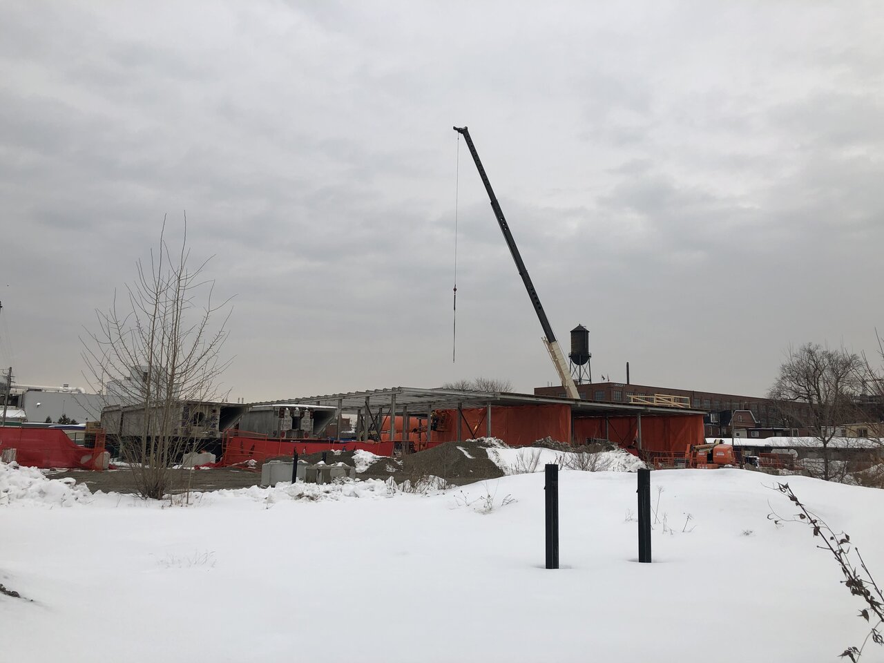

Any idea what's up with the scaffolding around those girders?
It looks as if the sections may also have to be grouted as part of the pre-stressing. If so, it may just be to allow access and to keep the snow off of them as the grout sets.
The plan is to build 1 track, and then once that's done, move service onto the guideway and commence construction on the 2nd track of the guideway - replacing the existing temporary diversion track.
They are not doing that. The erecting truss that they are using is designed to straddle both beams.
You are correct that they will be putting one track into service before the other, but that has more to do with the tie-ins to the existing track and the requirement to finish a section of the MSE wall on the north end only after the ground-level track is removed.

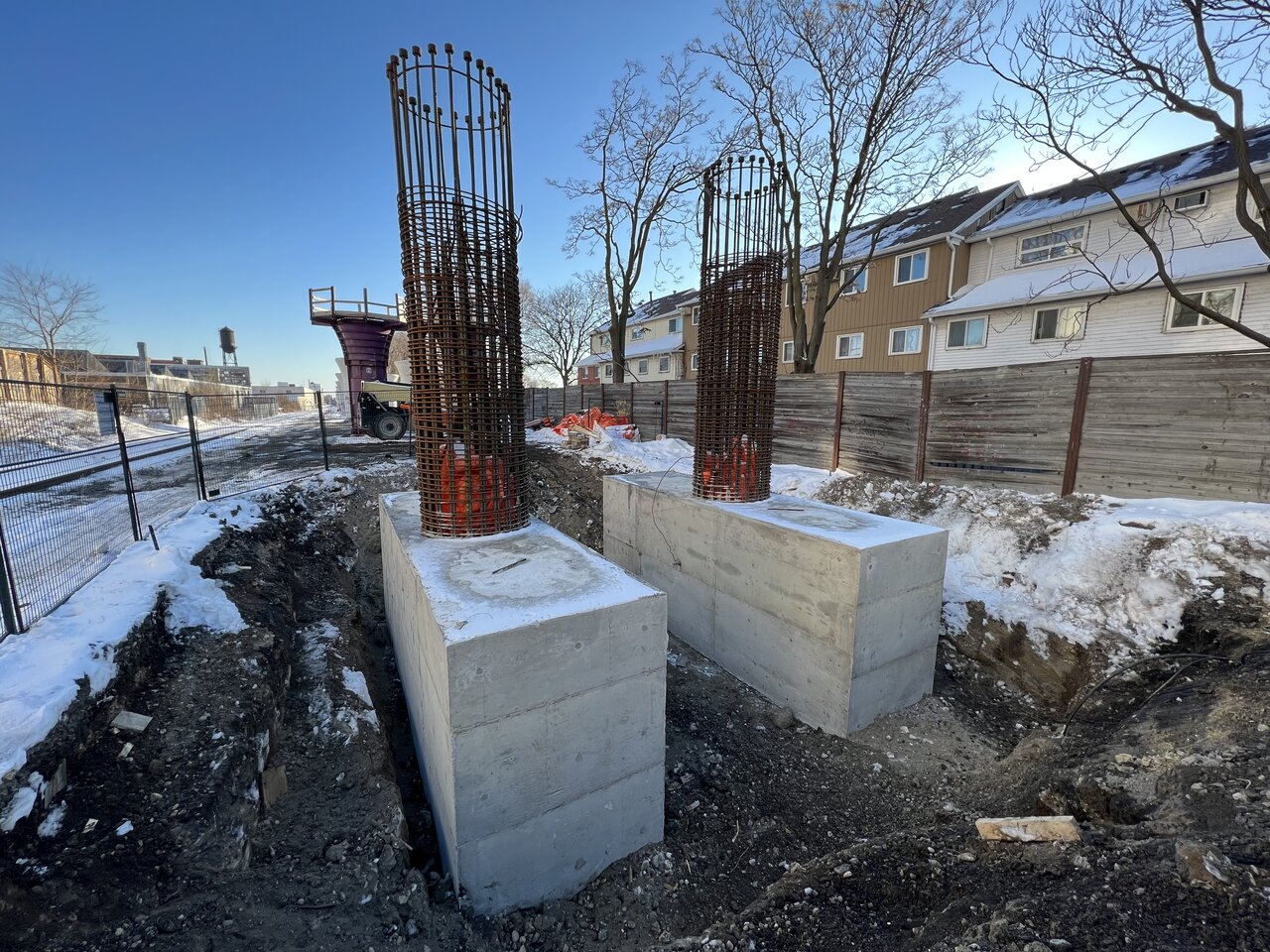

2 tracks are being built with just the tie-ins at the endpoints to be done in stages. The current diversion track will become a path.
okay now im confused, the GO RER will make this 2x track, are they building a 2nd guideway once the first is finished? or is that being left for the ONCOR project
The overpass under construction is 2 tracks wide; one track directly over each line of pillars.
