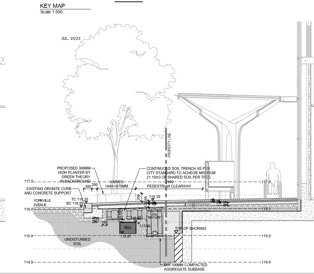

Notable here is addition of many new street trees with high quality planting conditions:

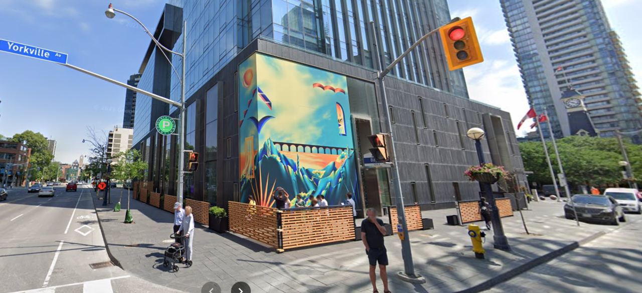

This is the existing Streetview:
So you can see that along with some added trees, the existing in-ground trees are being swapped out for shared open planters with soil cells. The only unfortunate thing is that the soil volume is still a bit light. (only 21.5M3 per tree) I would really prefer to see more.

Trees will be Elms, supported by an understory of Yew and Feather Grass

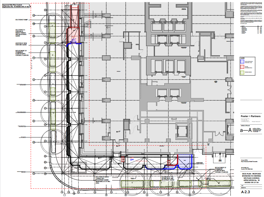

Site Plan Amendment application to further amend the previously approved Site Plan Amendment application for the site (File No. 18 203283 STE 27 SA) to permit a raised terrace and canopy at the southwest corner of the existing building along the southern portion of the west (Bay Street) façade and along a portion of the south (Yorkville Avenue) façade. This application would modify the previous approval to reduce the northern extent of the canopy and eliminate a ramp along Bay Street and expand the eastern extent of the terrace under the approved canopy along Yorkville Avenue.
