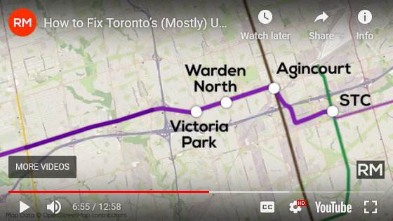

You said
As pointed out in the video going from just south of Agincourt could be above ground if cost is THAT big of an issue, there’s a ton of space and OL has shown it’s politically feasible.

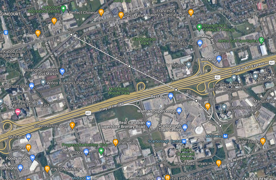

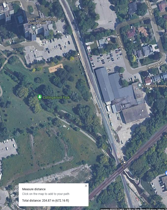

Let's review your imaginary alignment. There is clearly no space to elevate immediately south of Agincourt GO Station, as you need to traverse the CP Mainline, and you do not have time to make the requisite climb. Even a steep gradient would not get you to the surface in time, never mind clearance.
Note that I made the favourable assumption that the train was fully turned south, with its north end abutting Sheppard.

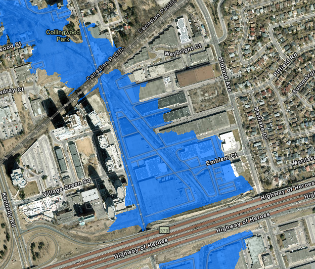

Once you're underground under the CP Mainline, you also have to stay under Highland Creek. Note then that if you brought the track up above grade between the creek and the 401, it would only be feasible if you were relatively shallow to begin with. But, there's a small problem............. You're going to emerge in the midst of the high-risk floodzone for the creek, which would make the tunnels vulnerable to water infiltration.
Blue is the flood risk from the TRCA flood risk map.
Assuming you avoid this by staying underground until you clear the 401......well, you'll note that the blue continues to the south.
I suppose you could surface in the middle of Progress Avenue and go elevated from there, but that will require considerable expropriation to widen Progress for a portal.
You would then have to rigidly follow the road alignment all the way to the proposed SSE station, and I'm not all clear how that's going to work, including turning radii with the new at-grade crossing of McCowan and the new road grid in the area.
As a side note, having now listened to your video..............The Sheppard line will be six-car trains not 4. That decision has already been taken internally for planning purposes.
