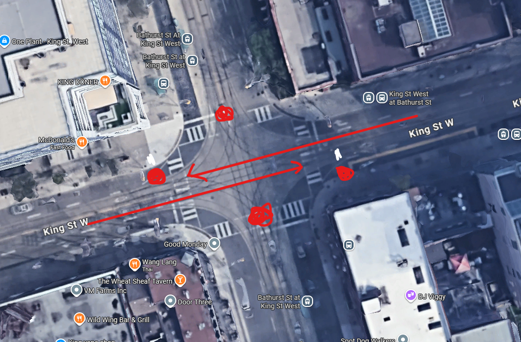

If the signal controller can detect switch positions, this would be possible in the same phase:

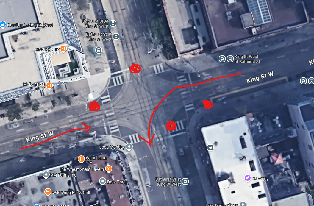

This would then also be possible:

You can't allow eastbound streetcars and westbound streetcars to proceed at the same time if they are both shown a white bar and there is a possibility of one of them turning left (or a bus turning left). The whole point of the white bar is to give priority to the direction seeing the transit bar
Furthermore your proposal would massively increase delay for streetcars since they would need to wait for the pedestrian countdown to finish to clear all pedestrians out of the intersection before they can receive their white bar.
Here's another issue, though. Are left turns supposed to be fully protected, or are they permissive? It seems like turning streetcars are supposed to yield to oncoming traffic when the right arrow for vehicles is lit, and pedestrians when the pedestrian signal is lit. And in that case, a white bar wouldn't work.
With your proposal, I take it that the white bar would shut off when the left turning streetcar approaches?
