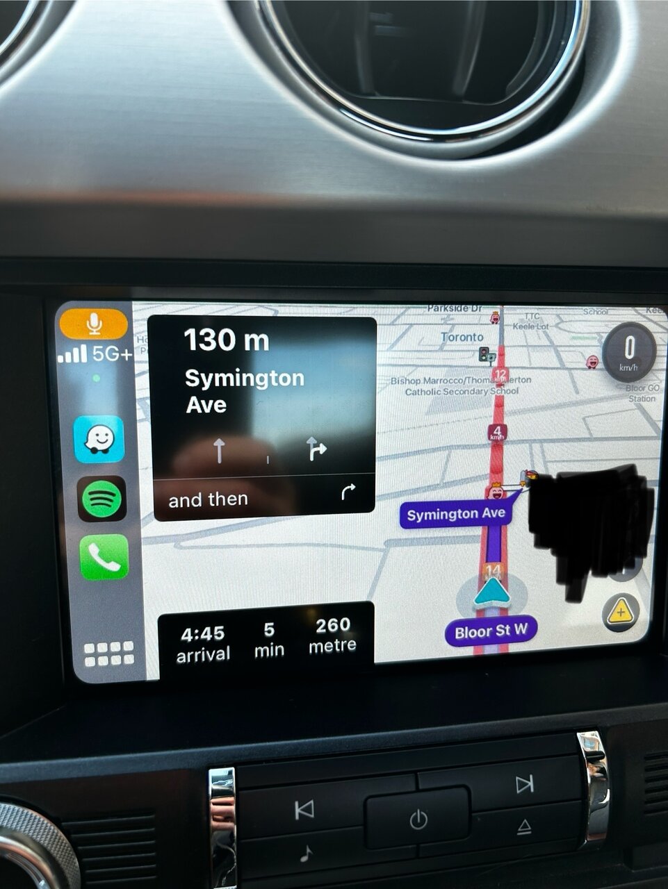

New traffic lights installed at Bloor and Perth are causing complete havoc to traffic in that area. Bloor and Symington is already bad enough with it's 3-phase setup and drivers getting confused and blocking the box all the time. Roughly 5 cars get through the Symington intersection going West. All this for what? So that pedestrians don't have to walk extra 50 meters to cross the street? I live in the area and mostly walk but this new intersection serves no purpose other than increase traffic and slow down the Symington bus. I will let this Waze estimate speak for itself, taken on a Sunday afternoon so not high traffic period.
I can't find any kind of evaluation of this signal. All I can find is a motion from councillor / deputy mayor Ana Bailão asking for a signal, and unlike a typical motion for a signal there is a total lack of any comments from City & TTC staff. The motion was passed by a large majority of City council in July 2022.
https://secure.toronto.ca/council/agenda-item.do?item=2022.TE34.232
If there is a staff report somewhere that I haven't found, I'd be willing to bet that they recommended against installing signals and the Councillors decided to do it anyway.

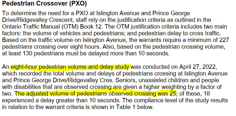

Thanks for digging up the report on this one.
Make no mistake the distance between pedestrian crossings is long here, but at the same time this is also a bus stop that's virtually never used. I mean frankly i'd even go as far as saying it's borderline useless due to the very light use and the city's own observations even alludes to it:
So if the city is going to use their rational here for installing a traffic signal, why dont they do it somewhere where there's a much higher number of crossings, where people are literally at risk of getting killed (ie: Birchmount and Rolark). I think this is the part that baffles many; there are legitimate spots where there's a higher need to traffic signals, but instead the city installs them in places where it's not really an urgent need.
Thank you for looking into this! Where do you look for the city evaluation of signal additions like this? I will reach out to Bailao to understand what the reasoning was behind this traffic light.
So you would rather the bus stop be removed? The current policy is to only have bus stops in places they can be safely accessed from both sides of the street, so either they make it safe for pedestrians to cross or they remove the bus stop and thereby prevent anyone in the neighbourhood from accessing the TTC.
Well i've seen the city and TTC go ahead and remove stops that are far more useful and used by far more patrons than the Ridgevalley Crescent stop. So in this particular case, sure they could go ahead. The ~30 people who use it daily would be upset but so be it.
And if it's the case where the policy is only to have bus stops where they can be safely accessed from both sides of the street, I cant wait to see the hundreds of unnecessary traffic signals the city will be adding throughout the city.
Those dwindling 30 people can use the stops at Princess Margaret or The Kingsway. This stop is an absolute joke, and it's borderline trolling that instead of logically removing the stop, the city only enabled its continued useless existence by incurring the expense of installing and operating the light. What a disgrace.
