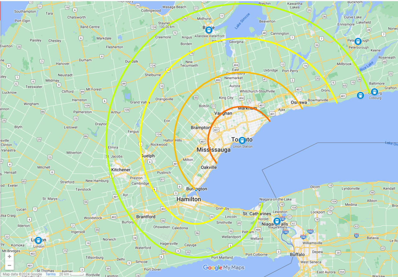

I made a map showing approximate distances from Union using concentric circles in 25 km increments (I modified it to adjust for traveling around the lake to get to Niagara Falls, since a tunnel under lake Ontario is not viable) and marked the above "destinations." Here are my thoughts abut them with GO, based on this map.
Niagara Falls: GO already provides limited service with express trains.
London: This is by far the furthest of the "destinations." and would be pushing the limit for usability of a stopping train. Probably best served by Inter-City Rail.
Barrie: GO already provides service to Allendale Waterfront. Doubtful if it will ever be extended into central Barrie.
Peterborough: As discussed before, it is largely greenspace between Peterborough and Agincourt. It would make sense as an HFR stop, not as a GO extension.
Port Hope/Coburg: There are plans to extend to GO Bowmanville. HxR would reroute the passengers from Ottawa/Montreal allowing VIA to have more trains stops at Port Hope and Coburg and would provide faster service than any GO train.

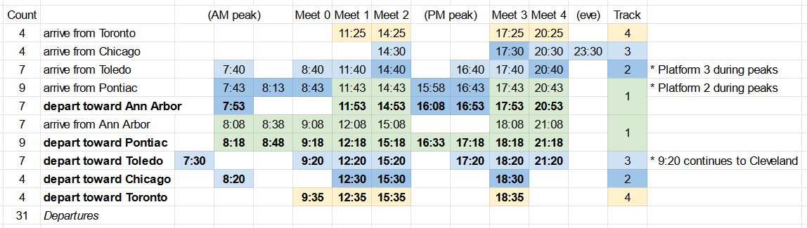

Here's a vision of how a relatively modest service level on both sides of the border could massively increase cross-border connectivity. The idea is that every 3 hours there would be a timed meet, where all or most of the lines would arrive and dwell, facilitating transfers. To allow time to clear customs, the VIA train would be first to arrive, and last to leave.
I assumed 4 platforms in service, because Ford has stated that they are protecting the 4 southern platforms for passenger rail operations. This is rather underwhelming - I would have wanted at least 5 platforms to enable growth for the 5 services serving the station.

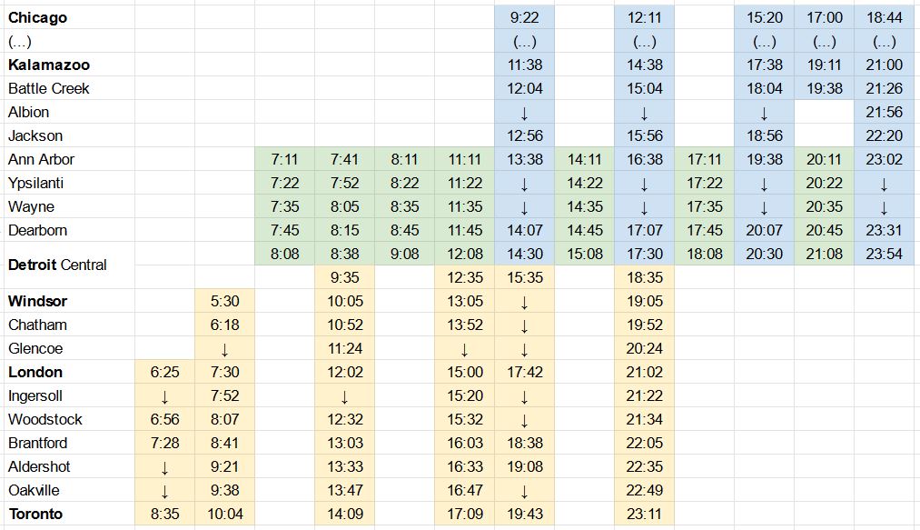

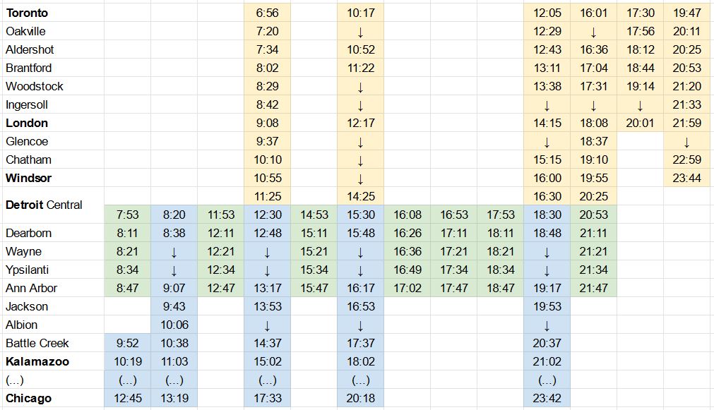

The below timetables are purely to illustrate the concept for timed meets, and the times of day at which they might occur. Any of these time slots may actually be occupied by other train movements and/or not be approved by the host railway. Travel times between Detroit and Windsor are also significantly reduced compared to current trackage.
I made these fantasy timetables a while ago and am not entirely satisfied with them, the dwell time for VIA should be much higher to provide a larger margin of error for passengers transferring through customs.
