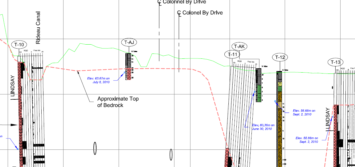

Don't want to go too far down a bunny chute on this, but actually, the idea of a tunnel, and even station platforms, under the canal is not technically preposterous. The canal is hewn straight into bedrock, which is just below the surface. Originally Rideau station was to be mined out spanning the canal, with entrances near the NAC and the current Senate building. Only later was the current location developed. It started to cave in because just east of Colonel By, there is a large and hidden glacial trench full of unstable rubble. It was actually the riskiest place in all of downtown Ottawa to build a station, so naturally it was chosen.
You could dig about 6 km of tunnels from the area around Hurdman and the current station converging under the canal. The station could be mined out or dug down by draining the canal for a few years. A concourse could be built across to the old station, and likely to the NAC area as well. The chances of any of this happening approach zero. It would cost billions of dollars, and would be a vanity project that on balance did not really improve access to anyone but visitors. Ottawa is used to vanity projects but I think this is a tunnel too far. Improvements to the rapid transit network would be much more useful.

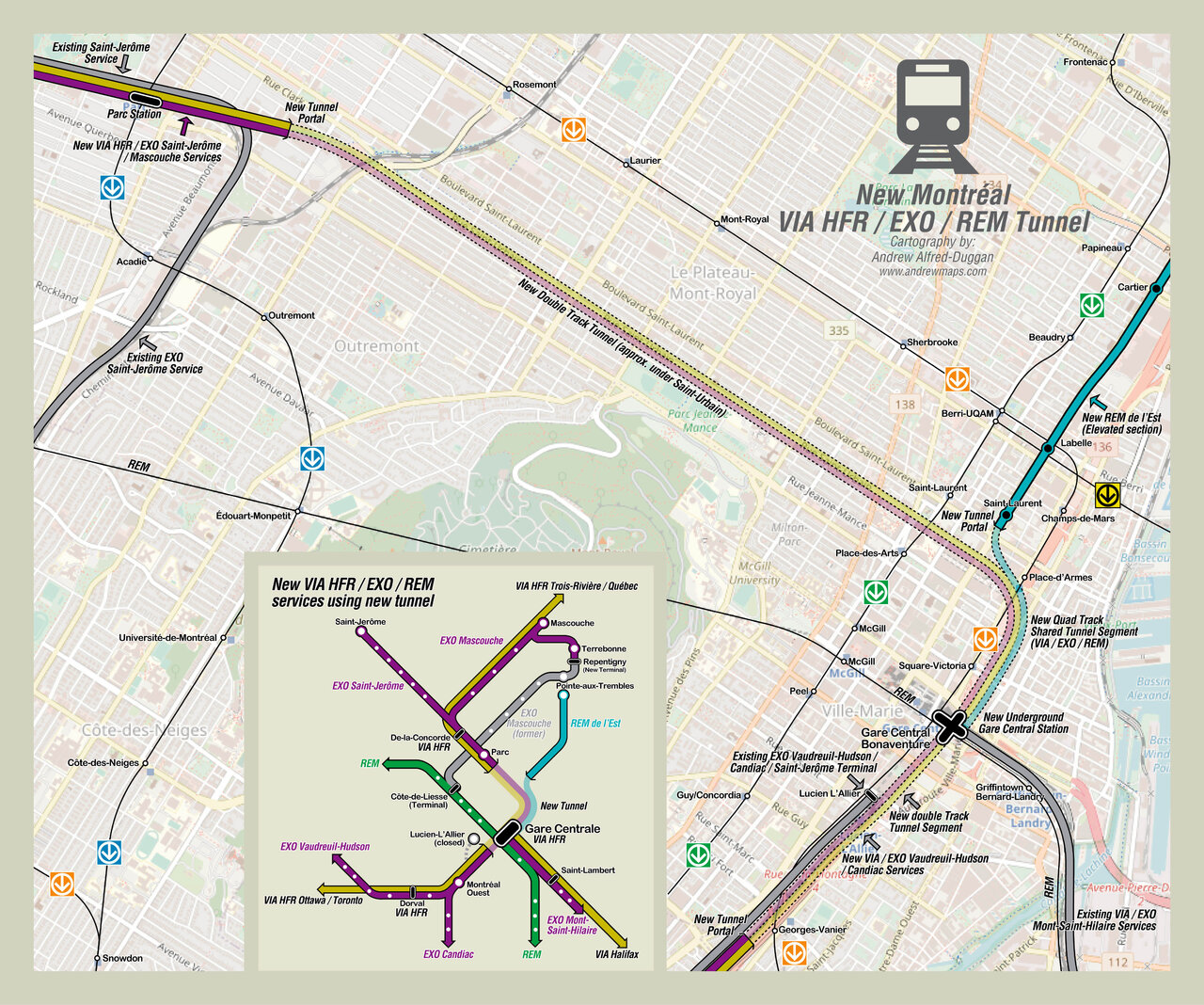

I've posted this before... But any tunnel idea would benefit in buy-in from EXO commuter trains (to help pay for it) - I wonder if they are thinking of that? - excuse this map has the old LRT de L'est concept. With only one underground station, it perhaps wouldn't cost toooo much?
Alto - HSR
If you zoom into the Montreal area, I laid out where I feel it could go. It is almost a straight line to the tracks it needs to meet north of the Mont.
