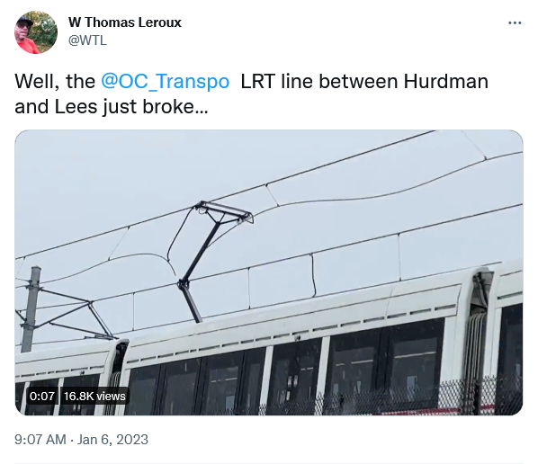

And then there's this:
Lets bring this forward for those lacking previews and the click-averse:
