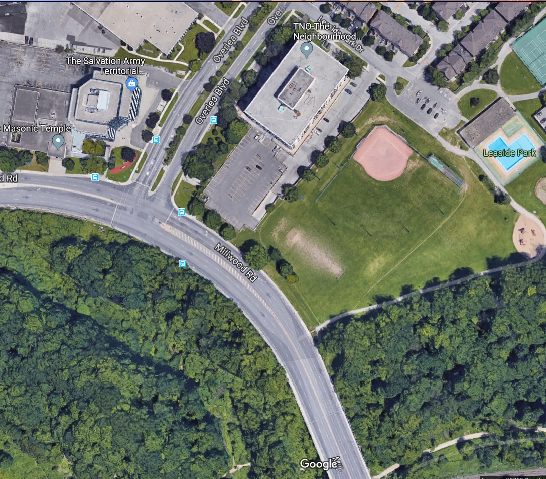

With only a parking lot, they can dig a curve from the bridge to under a new TBM site in the parking lot. Continuing under Overlea Blvd.

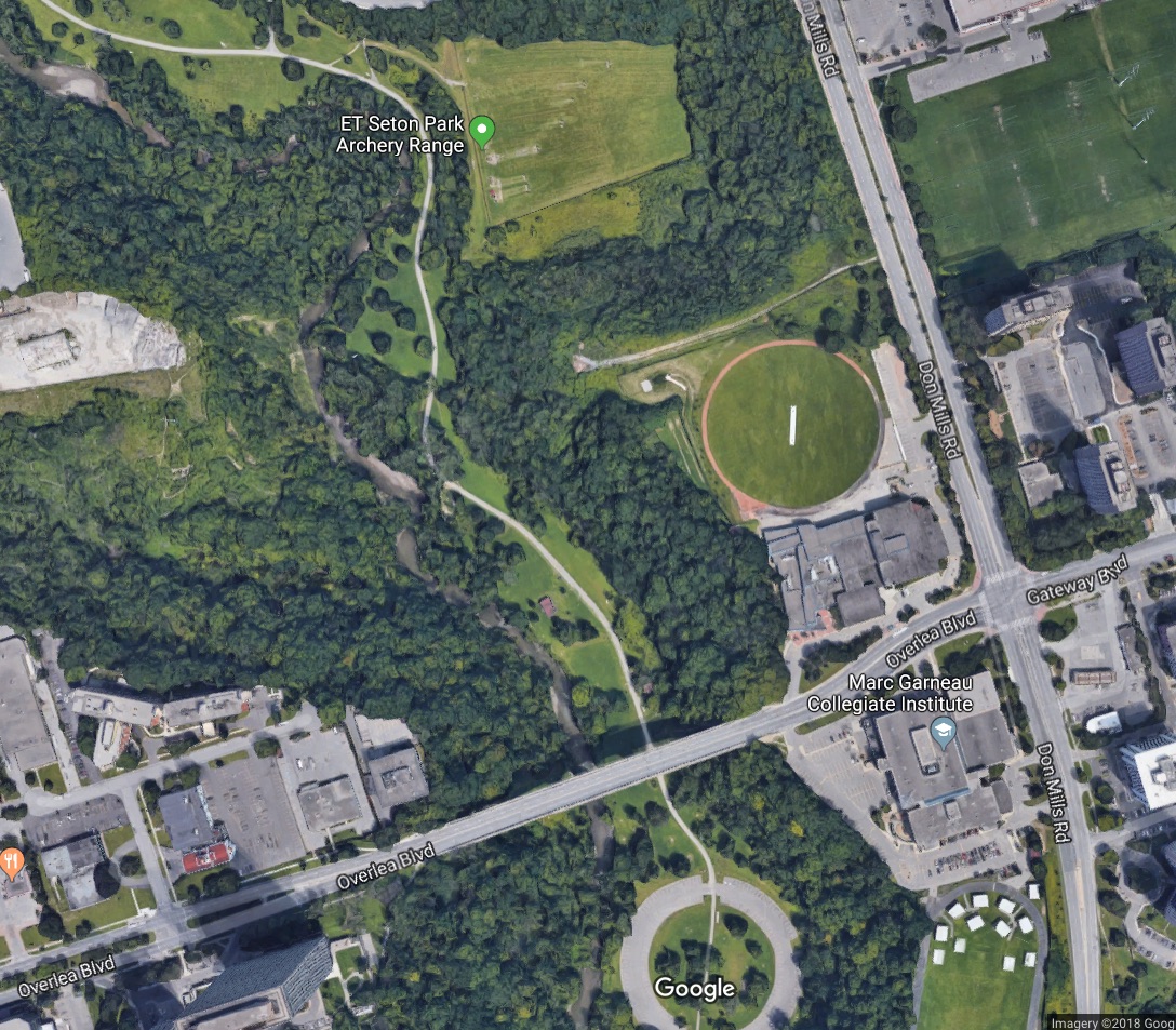

It's the curve from Overlea Blvd. to Don Mills Road that could present some problems. Maybe they replace some schools in the construction.
