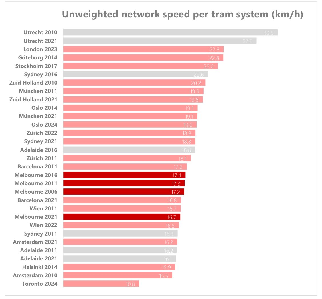

That's 2013. See this PDF from August 2024 at https://t.co/PUpHoVyctk
The Utrecht and London systems are not comparable to the TTC streetcars. In London, those trams operate in the soutrhern suburbs, no line crosses the city centre.
Utrecht's line crosses the city centre, but most of the length is in the suburbs where it serves as a (relatively rapid) transit trunk. See https://en.wikipedia.org/wiki/Utrechtse_sneltram
Amsterdam's trams, on the other hand, are very much comparable to TTC's. They run through the old city centre, on streets that are much narrower than any streetcar avenue in Toronto. And yet, they achieve 16 kph average, versus 11 kph in here.
I can think of one street in Amsterdam where there is a short, single bidirectional track for the trams. It works.
Or Melbourne, which has many similarities to Toronto, and is 50% faster on average even in their worst performing years. Anyways, it's getting really OT.

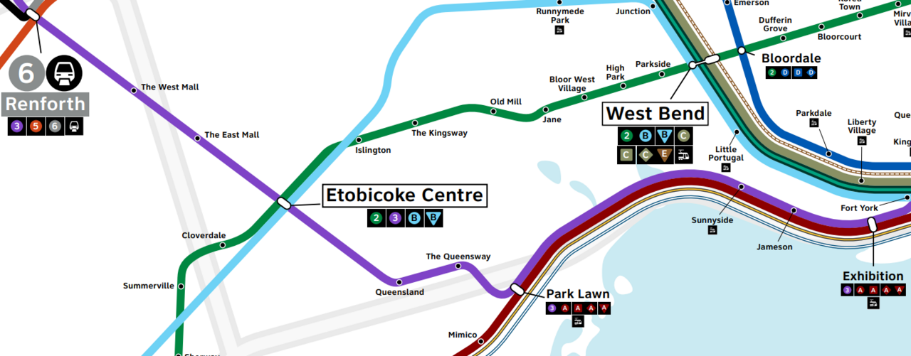

I would vote for this westerly extension of the Ontario Line. Service Jameson and the south end of Roncesvalles, connect with services at Park Lawn, serve the core of the Queensway, and go direct to the airport hitting Etobicoke Centre and the highrise areas of the East and West Mall along 427.

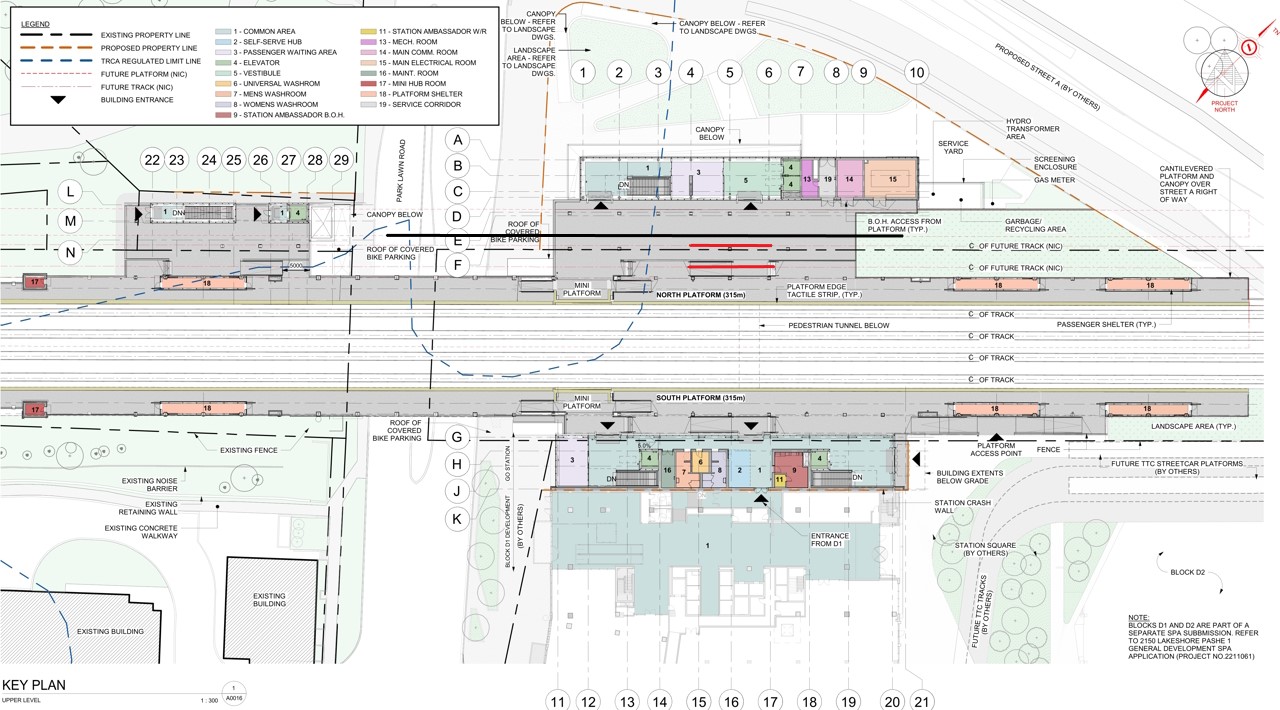

I think its been mentioned before, but the "Future Track" (top below) on the Park Lawn station supports the OL extension through there.
Additionally, the underpass under the Gardiner for the rail corridor already has an un-used box for 2 tracks on the north side:
My thinking is the line would continue along Queensway and then surface up the Metrolinx-owned rail corrdor just past Kipling...they could probably work out a project with TTC that the Obico and Purolator lands (all already owned by the City) could fit two western yards (although not shared, because of rail gauge), one each for Line 2 and Line 3, and a western LRT barn. As for the route up to the airport from there, likely along East/West Mall then connect into Rentforth. If they got their act together, they could build a shared tunnel from Renforth into the airport for Line 3 and Line 5...likely 4 tracks because of catenary vs. 3rd rail.
That underpass would have been built in the early 90’s when the Gardiner was rebuilt and upgraded around the Humber River. So definitely not planned for the OL or rapid transit and instead likely planned for some amount of mainline rail trackage. At that time CN was still operating in the area and may have wanted protection for seperated trackage for all we know.

The Park Lawn GO station will surely be built before an Ontario Line extension is considered.
The current station design reserves room for two future tracks on the North side of the existing 4 tracks.
A good reference here:
An alternate drawing and view:
Here I have again highlighted the final north platform edge; but this time I have highlighted the new tracks - centreline in red.
Since there is no room for two additional GO tracks through Exhibition, I think a future extension of OL to Park Lawn generally makes sense. ~5.8km at/above grade, few opportune locations for stations (eg. Windermere, Roncesvalles/St. Josephs, Jameson/Dunn).
The most expensive challenge would be the corridor widening; a bit of GO track shifting to the south, retaining wall construction along the north, and road bridge reconstruction at Dufferin (likely to be completed sooner by City/TTC), Dunn, and Jameson.
That does seem to be the intent - the Dufferin Bridge replacement is currently on hold pending conversatins with Metrolinx about the "Ontario Line", despite the phase 1 OL tail tracks not reaching Dufferin. I suspect Metrolinx wants to preserve for a future western extension.
