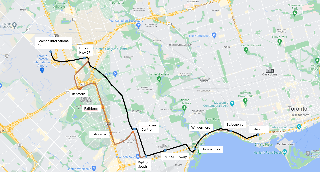

Here were 2 of my options for future extensions of the line. Feel free to critique as required:
I have missed a lot of local stations in the above fantasy map. There's a lot of room for improvement.

This is how I pretty much envision it - travelling west to serve Humber Bay then up along the Queensway to either Kipling or the 427 to serve density appearing in those areas. All mostly elevated / at grade to avoid tunneling.

As far as the general conversation: Going north and west both provide a level of duplicate service with GO early. It's where the line goes after that that breaks new ground. Both directions make sense.
Thanks for sharing. Could the OL rolling stock make that tight of a turn by Humber Bay?
Honestly don't know what the specs of the OL rolling stock is going to be. But looking at Google, it shows average turning radii of 60 - 80m which would fine in that area. In any case, the line would have to be underground in that area.
