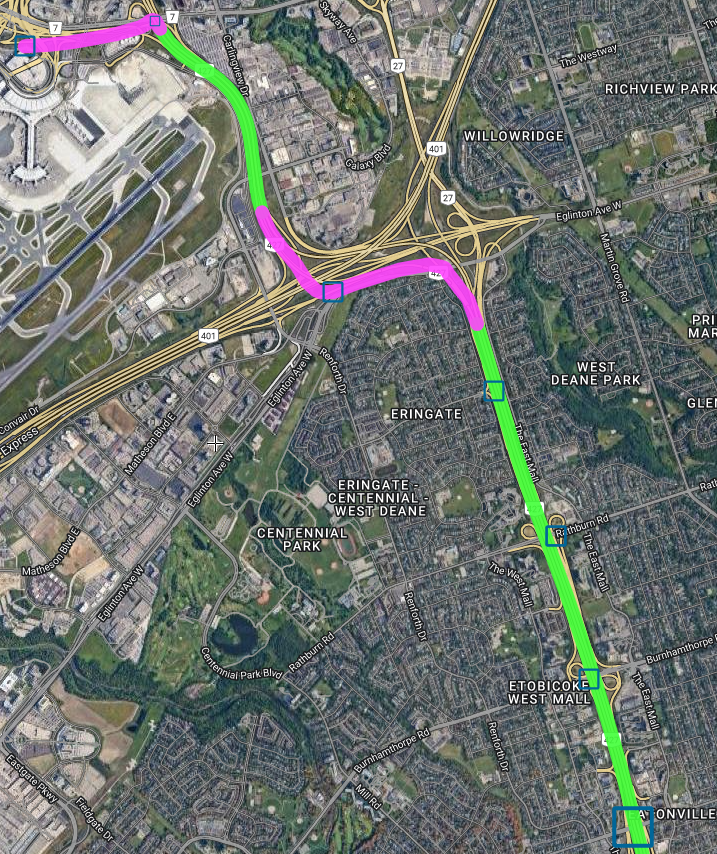

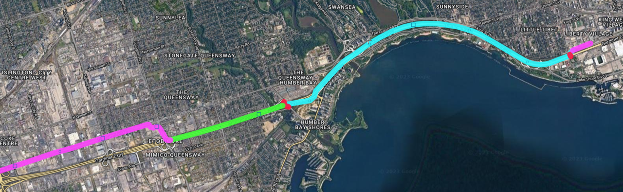

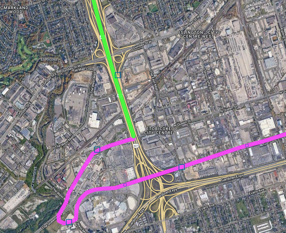

Ontario Line West Extension
This is my proposal for a western extension of the Ontario Line, including exact routing, rough station locations and explanations for each section of the line. To preface and prevent any confusion, this is set roughly 15+ years in the future and assumes that the Gardiner east of Park Lawn has been capped and eliminated as a highway, with the entire structure east of Exhibition being destroyed. However, west of Exhibition the former Gardiner R.O.W is preserved and used to create a widened GO/OL corridor. Additional tracks are added to allow for future express/branch lines or interlining with any future TTC/GO project.
These three images are a relatively low detail rendition of the full map I created on a separate platform. The link to the full map is below and on it each portion of the line and each station have in depth explanations given for them.
I hope you find my proposal interesting and I welcome feedback and advice.
The colour key is as follows:
Blue = Expanded GO Lakeshore West Corridor
Green = Highway Median
Pink = Elevated Track
Section 1:
Starting from the current OL terminus at Exhibition, the line runs along the repurposed Gardiner R.O.W until Park Lawn road. The OL will have a connection with the currently under construction Park Lawn GO Station. From here it enters the median of the Gardiner Expressway and runs at grade so as to not conflict with the low bridges over the Gardiner along Royal York and Grand Avenue. There is already a substantial median on this portion of the Gardiner so no major lane reductions (if any at all) would be needed. Arriving at Islington, the line raises off the Gardiner and runs elevated over what is currently the Cineplex parking lot on the south west corner of Islington/Queensway. It then runs elevated down the center of the Queensway. An elevated trackage further east of Islington on the Queensway would not be possible due to the narrowness of the road and existing suburban homes.
Section 2:
Continuing elevated along the Queensway, the line has a flyover over the 427/Gardiner interchange. From here it continues elevated along the Queensway until the West mall where it turns south to a station on the north side of the existing medical facility. Thereafter looping north-east, there is an additional station as close to the rail corridor as possible to allow for an easy transfer from the future Line 2 extension to Sherway from Kipling along the rail corridor. Briefly after this the line runs elevated along North Queen Street, then enters the median of highway 427.
Section 3:
The final and likely least controversial portion of track continues along the median of the 427, then runs elevated over the interchange of highway 427, 27 and the 401. There is a westwards run towards the eastern terminus of the Mississauga Transitway and future Renforth station of the Eglinton Crosstown Western Extension. Turning north again the route runs elevated again for a short time before entering the median of the 427 before making a western turn onto the ground of Pearson Airport. Here it once again runs elevated to avoid the complex road network below, before finally ending north of the terminal where a new station will be constructed adjacent to the existing building.

I do think it follows the the 427 too closely, and also that diversion to Sherway Gardens is a bit match. A better choice might be to make it a general Kipling RT line.
I looked closely into the following the old Kipling RT plan, but apparently the hydro corridors are no longer available for transit? Something to do with the provincial ministry. The other issue with that route is it misses all the existing and future density in Sherway gardens and along the 427 (west/east mall). I don't think building a whole light metro through deeply suburban central etobicoke is worth the cost.
