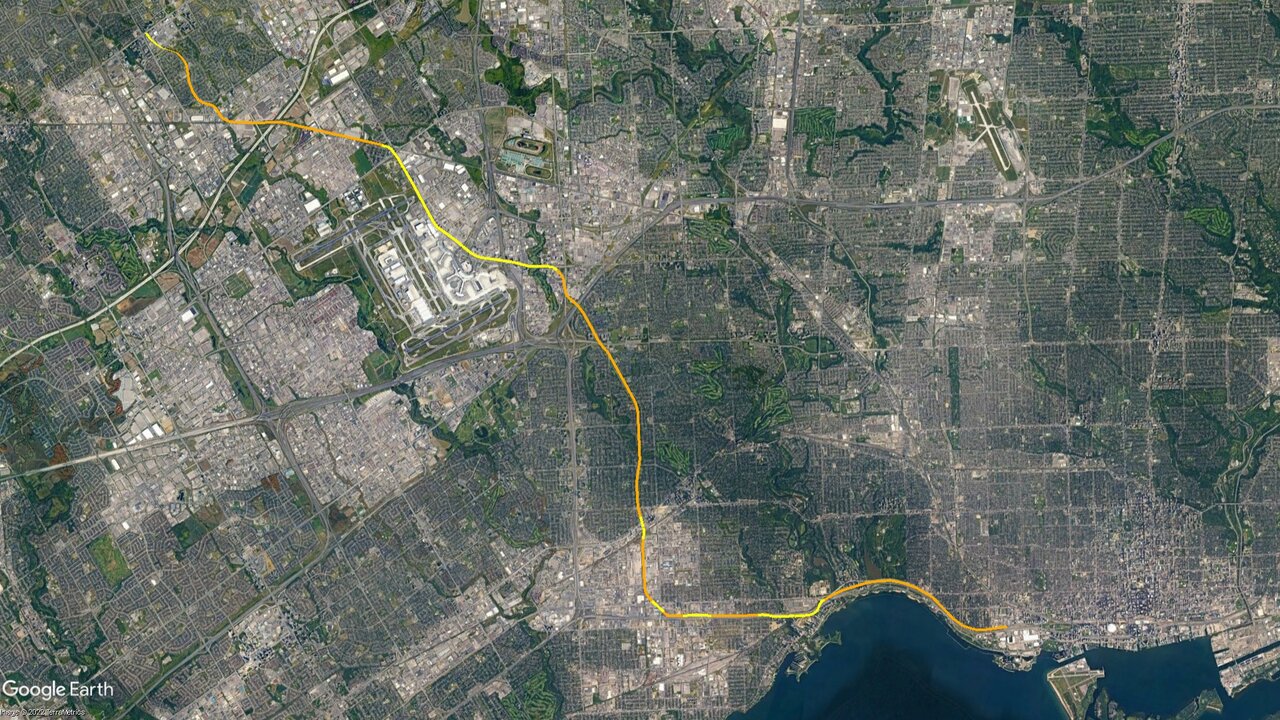

My idea for an entirely elevated / at grade OL extension all the way to Bramalea City Centre in Brampton.
Basic idea would be that it runs along the LSW corridor to Humber Bay, along the Gardiner to Canpa, up Canpa to Kipling, up the Etobicoke Hydro Corridor to Dixon, across Airport Rd / Dixon by the airport, up the Kitchener corridor to Bramalea, then circle through existing natural connections to Bramalea CC (that last part may be politically challenging).
Yellow = Elevated
Orange = at-grade
This could be built in 3 phases, Exhibition - Kipling, Kipling - Airport, and Airport - Bramalea.
Interesting idea, though I'd be tempted to use the 427 instead of the Kipling Hydro corridor. The constructability challenges would be similar, but there's a lot more ridership potential along the 427 corridor. Going to Bramalea City Centre is an interesting idea though.
Yellow = Elevated
Orange = at-grade
Any thoughts these days of using the Hydro Corridors for Transit is DOA As Hydro One is Protecting them for future needs
There is no room in the Lakeshore Corridor for the OL extension as Metrolinx has protect it for a 5/6 track west of Dufferin St as far as I know.
The thoughts of using an elevated line on the Gardiner must take into consideration of heights to get over ramps, overpass and other issues. Far off using the Queensway west of the Humber to Sherway as it will service the area better than the LSW or the Gardiner.
Again, any thoughts of using an elevated line on the 427 must take into consideration of heights to get over ramps, overpass as well flight paths for the airport. How does 427 service the areas along it??
Any roads where the elevated line is to go in will require one lane in each direction to be out of service to build the support columns and the guideway from 10-18 months that will go over like a lead balloon with the car community and MTO.

Extending west along the gardiner but not to Sherway is a miss. Sherway is slated to receive massive development in the coming years.
Sherway is tough to serve with a through line though, because it would be an awkward curve in and out. Personally, I think it would be better served with an extension of Line 2.
There are some examples of elevated median infrastructure going over top of overpasses. Here's an example from the Katy Freeway in Houston (granted it's carrying vehicular lanes and not transit, but the structure would be quite similar). I don't think the flight path to Pearson would be an issue, given that the high-mast lighting on the 427 is already taller than what any guideway would be.
When I met with MTO staff almost 20 years ago about an RT on the 401, I said it was easy to have an elevated line over all the overpasses as well maintaining a level guideway where dips and valleys are. Also to have stations at various overpasses. As for the flight path, its something to keep in mind as it will only take one low flying plane to have a major impact on everything.
As for the curb at Sherway, it can be done fair easy by doing an 90 degreed turn at the West Mall and then angle it north to the centre of the 427. Nothing wrong in having both lines going to Sherway when they server 2 different markets in the first place. Not an support of line 2 to to Sherway.
