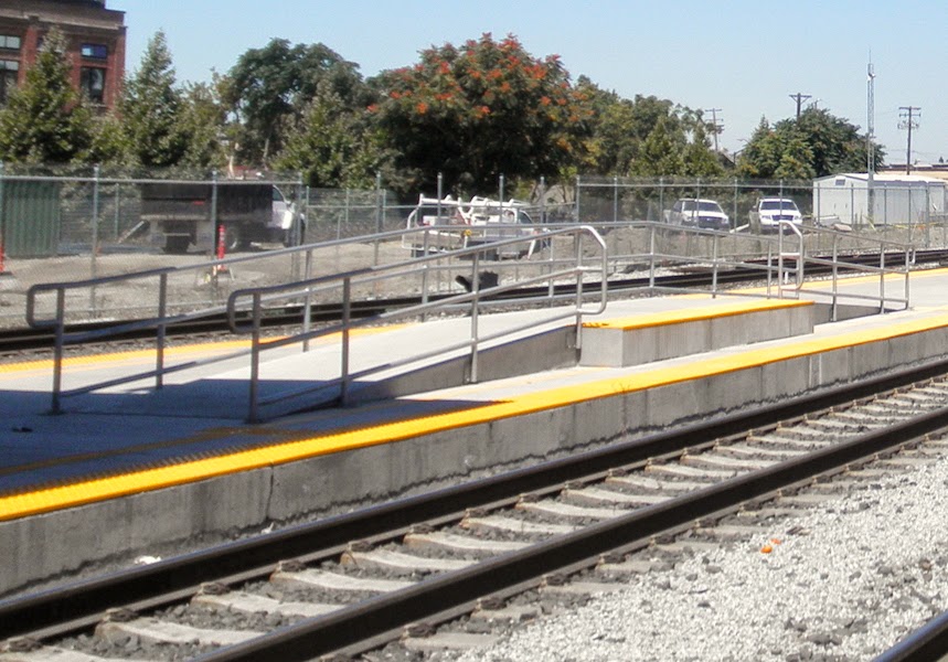

Mini-high platform built on top of
8-inch platform. The top of the
mini-high is at 22 inches ATOR.
This is primarily an issue of wheelchair boarding. Matching the new EMUs to the 25-inch floor height of Bombardier cars allows Caltrain to procure EMUs without vehicle-borne wheelchair lifts, which are expensive to purchase and maintain. Instead, the EMUs would re-use the existing mini-high platforms to perform wheelchair boarding, using a bridge plate to span the large gap between the mini-high platform and the train. (Recall this ~3-foot gap is present in the first place because of a California PUC regulation on side clearances for freight trains).
