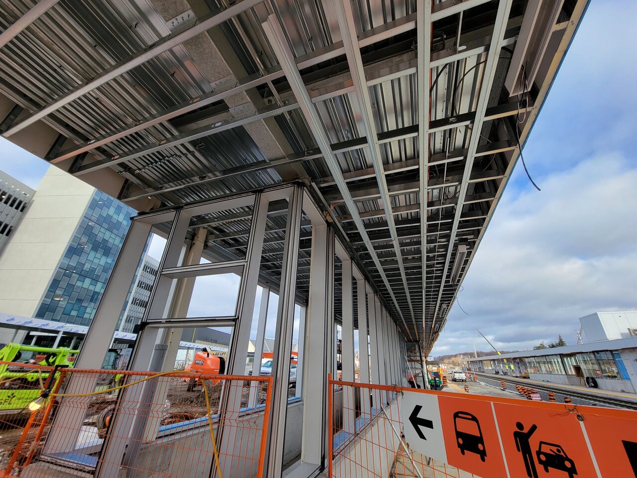

I have set aside my preference for 1220mm platforms, and instead I'm trying to generate support for the 610mm standard that GO has selected:
Saw you're at Rutherford in the video - correct me if I'm wrong but the heated enclosures on the platforms are also built for the eventual height increase. The window directly above the door seems like its cut in 2 pieces so that when they raise the height, the bottom section of glass is removed and the door is simply raised into the new frame.

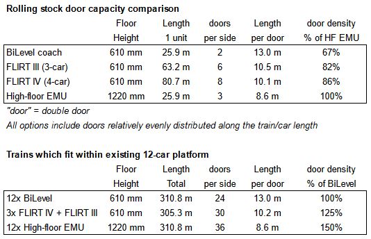

Regarding our earlier discussion of the boarding efficiency of different platform heights, I decided to do a comparison of rolling stock.
For 610mm double-decker coaches, I used our current BiLevels. I excluded the locomotive because it doesn't need to fit on the platform.
For 610mm single-level EMUs, I used the Stadler FLIRT, which is currently the only FRA-compliant single-level multiple unit with 610mm. I combined the floor height of TexRail's FLIRT DMUs with the other stats of NS's FLIRT EMUs.
For 1220mm single-level EMUs it's technically possible to have more than 2 doors per side, but I couldn't actually find any FRA-certified examples. So I used a hypothetical version of the Kawasaki M8 with 3 doors per side.
So it looks like even with GO's 610mm standard, single-level EMUs could have 25% more doors per side than GO's current trains. And considering that single-level trains would have fewer total passengers than BiLevel trains, the time to load and unload passengers at stops should be considerably lower.
It looks like low-floor single-level EMUs could nicely complement BiLevel coaches, with the EMUs operating local services on the central segments (e.g. to Bramalea, Aurora), while express services continuing further out are operated by BiLevel coaches hauled by diesel/bi-mode locomotives (e.g. to Kitchener) or electric locomotives (e.g. to Barrie).

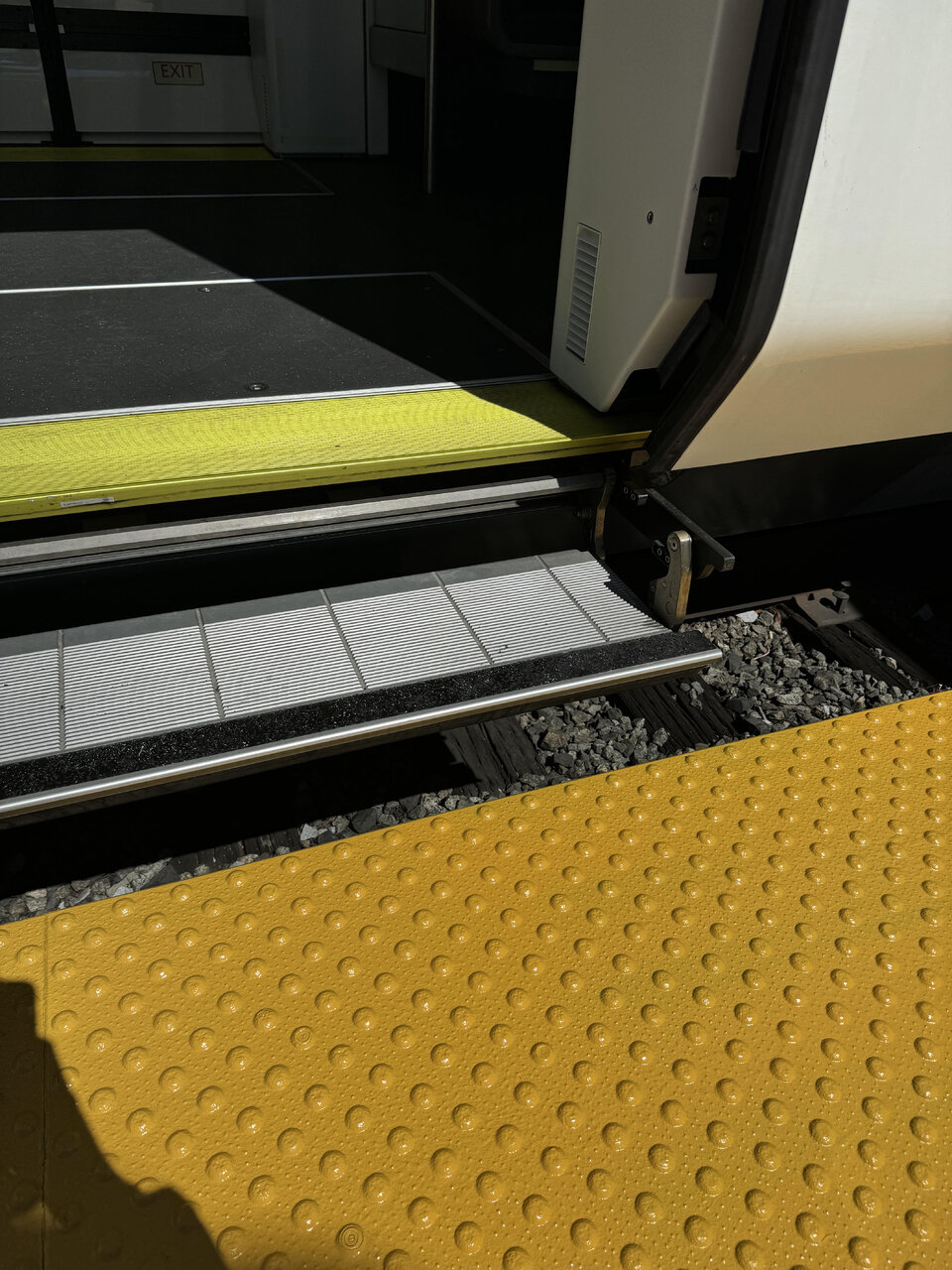

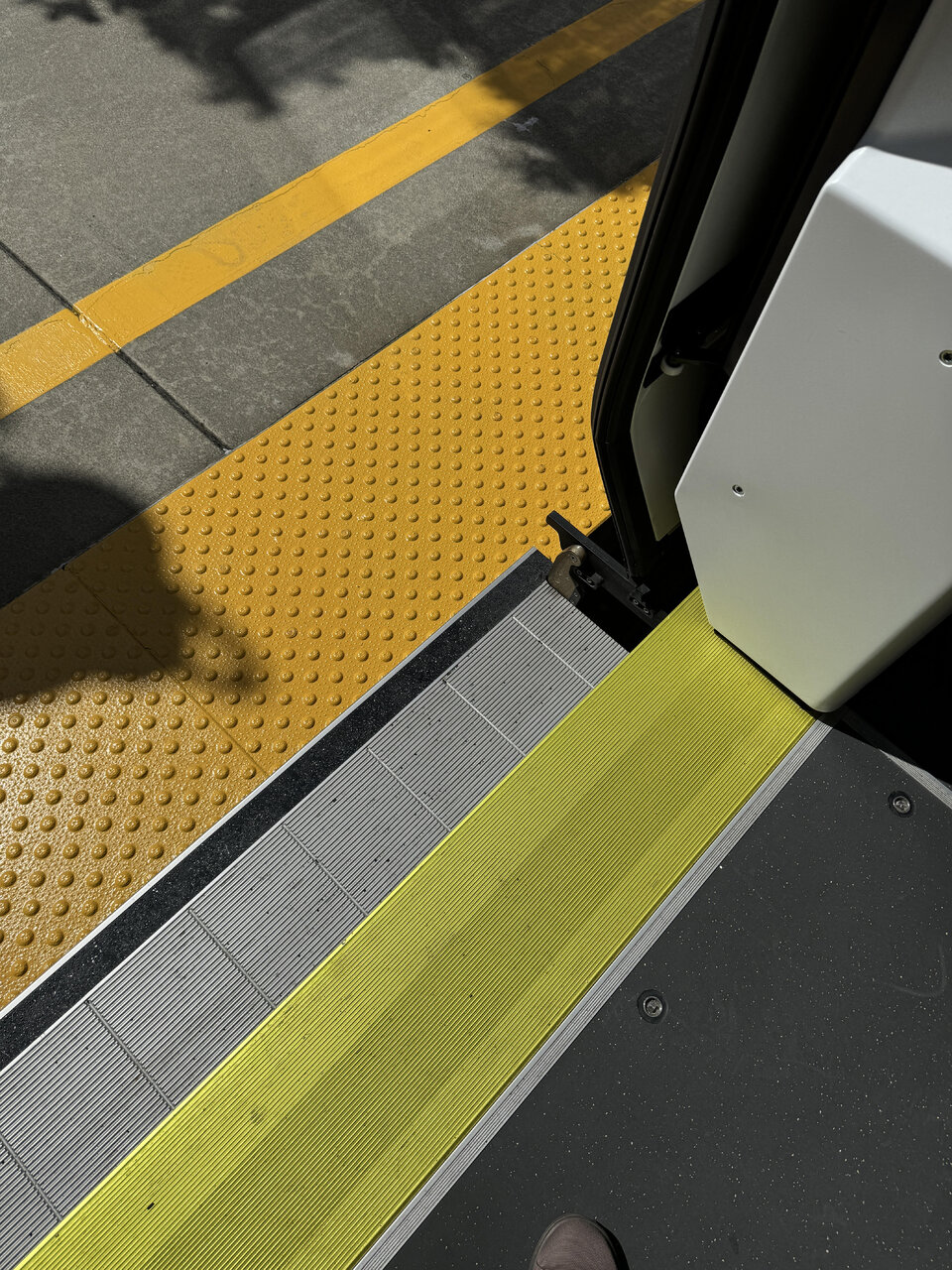

Just got off the new electric Stadler KISS Caltrain EMUs.
In terms of platform height and the process of migrating the system from one standard to the other, one thing that can work is retractable steps. So whole stations can be lifted individually, and the work can be staged.

View attachment 598428View attachment 598429
Yeah an adjustable step is pretty much the only way of transitioning from status quo to level boarding without shutting down a line for months, though I'm not sure if CalTrain's is actually capable of level boarding considering their level boarding platforms are planned to be at 50" (hence the doors on the middle level).
But I heard an unverified rumor that Alstom has determined that it isn't possible to retrofit an adjustable step to our BiLevel coaches. Which would explain why we're still stuck in the 'future-proofing' stage nearly a decade after establishing the 610mm level boarding standard - they should have been raising platforms by now. If true, it would add a complication to Alstom's original proposal to keep nearly all of the current BiLevels post-electrification. If EMUs could provide level boarding while BiLevel coaches can't, that tips the balance a bit more in favour of EMUs than they might have originally estimated.
