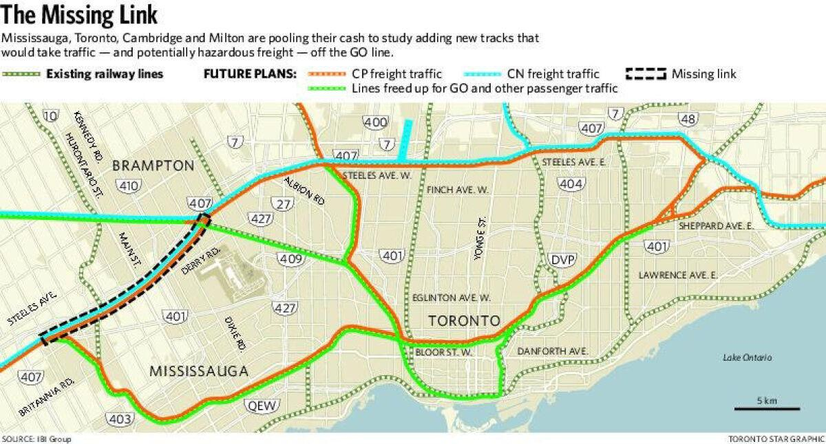

Part of the hope for the Missing Link (at least from the perspective of cities like Mississauga) is that the CPKC trains could be diverted to share the York Sub with CN, giving full access to the Milton Line and Midtown Line to Metrolinx.
Its worth noting though that as far as I know, this was a hope that was only expressed by local municipalities, and was never claimed as a major selling point by Metrolinx. This is why I added the "or something to that scale" detail since my point was the number used was likely based off some over the top design for a new rail ROW that is at least comparable to the scale of the Missing Link.

Part of the hope for the Missing Link (at least from the perspective of cities like Mississauga) is that the CPKC trains could be diverted to share the York Sub with CN, giving full access to the Milton Line and Midtown Line to Metrolinx. View attachment 539120
Good luck with that CN - CP connection at Humber/Woodbridge... the CN grades there are already close to 1% going in and out of the valley, add in going even further down in elevation for the CP track and you are talking maybe 2% grades. Also good luck getting CN and CP to share track that close to CN BIT yard and Macyard.
Yep. The missing link only makes sense for CN. CN will never let CPKC trains that close to their yards. It would impede their operations. Plus the Goreway bridge is currently being constructed, and only being made wide enough for CN tracks. The best option for CPKC is to divert their mainline around Brampton and connect to their Intermodal yard in Vaughan from the west.
Yeah, like that would ever happen.
The solution, like the letter mentions, is additional tracks and grade seperations.
