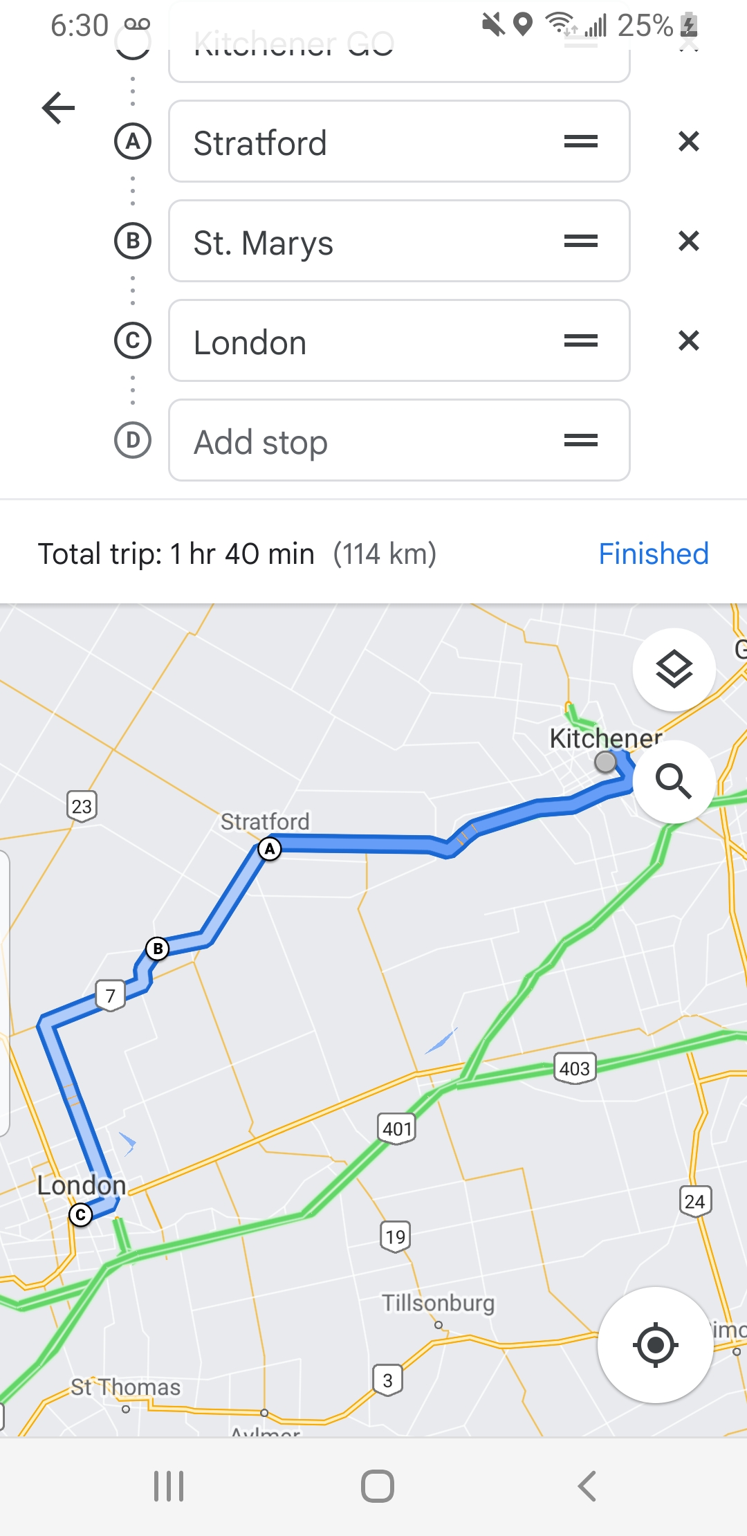

Also an all stops bus is a good 30 minutes faster than the train
Makes you wonder if they should just extend the route 15 that already heads in this direction from Brantford. Or create a Kitchener-London express bus the exact same way the route 30 is set up. Both options would probably work out for the better especially the 15 as its McMaster stop could help the university-university travel and the Aldershot connection obviously being a better one compared to starting at Kitchener.
Go Transit already has a bus maintenance yard in Kitchener so setting up daily busses between London and Kitchener shouldn't be to hard. It might be better in the short term while they fix the tracks.
