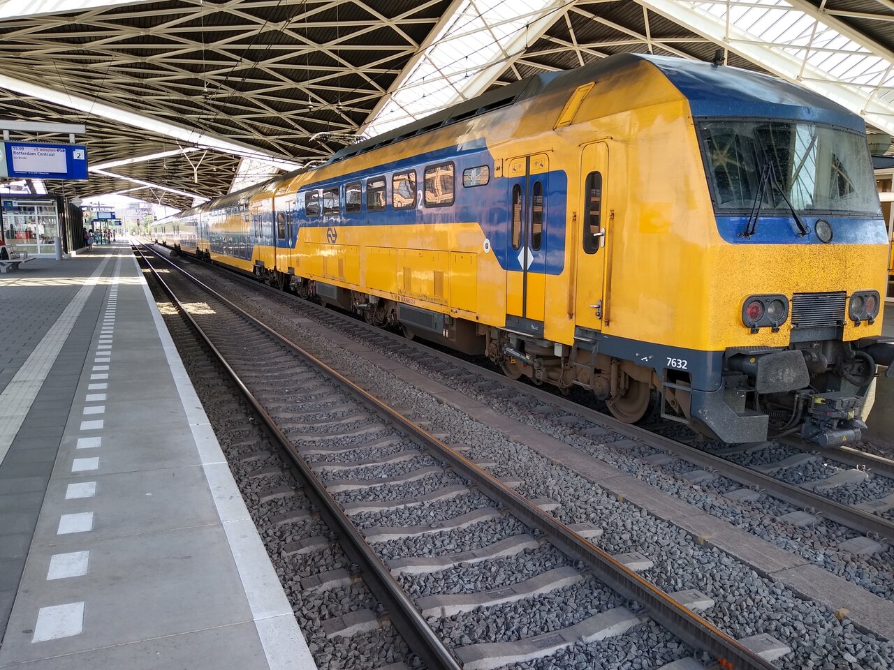

This was my understanding as well, and it matches my acceleration measurements of trains here in the Netherlands: EMUs accelerate faster from a standstill due to better traction, but locomotive-hauled trains can accelerate faster at high speeds since they have a higher total power output.

One of the Dutch "EMU" types, the DDZ, is actually more of a loco-hauled consist since all of the traction equipment and motors are in a single coach. But that coach was built with a really complicated 3-bogie arrangement in order to increase traction - even though it only ever propels 3 or 5 other coaches.
Personally I find this third bogie to be an overcomplicated solution, given that it needs to be able to slide sideways as the train rounds bends. It seems like it would be cheaper to just install a motorised bogie in the first coach adjacent to the locomotive, with power fed directly from the locomotive. This would also provide 2 additional powered axles, but would make use of the weight of that coach, rather than dividing the weight of the locomotive among more axles.
If GO added a powered bogie to the coach adjacent to the locomotive, the trains could potentially provide EMU-like acceleration with the existing BiLevel fleet, without the cost of converting them to actual EMUs. Almost all of the electrical equipment (pantograph, transformers, control system) are already provided in the locomotive itself, and wouldn't be needed in the powered coach.
This is basically how it works, yes. Below a certain speed (approximately 32mph, but also dependent on things like the final drive gearing), the traction systems simply can't put all of their power down to the rail, so they are limited by the traction available. Above that speed, the full amount of power becomes available, and so the higher the horsepower available, the faster the equipment will accelerate.
This only applies to electric transmissions, for the record.

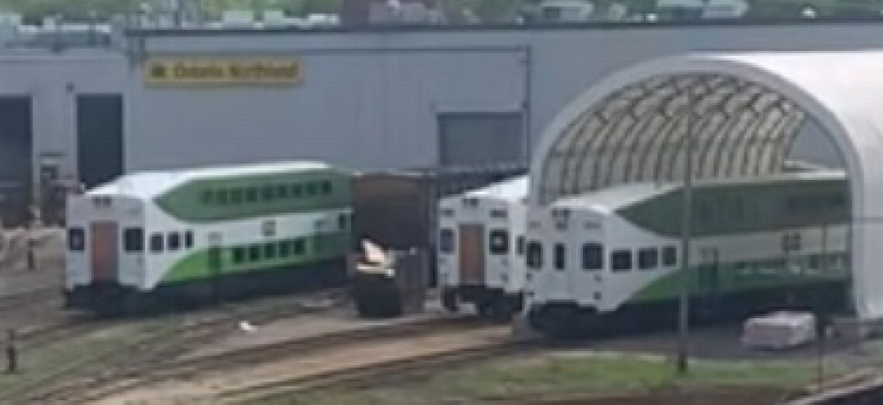

This may be something trivial to most, but for me, I hope that when ONR is done with refurbishing the Series II cab cars, MX puts the reflector stripes back on the front. That makes them look even better in my opinion.
