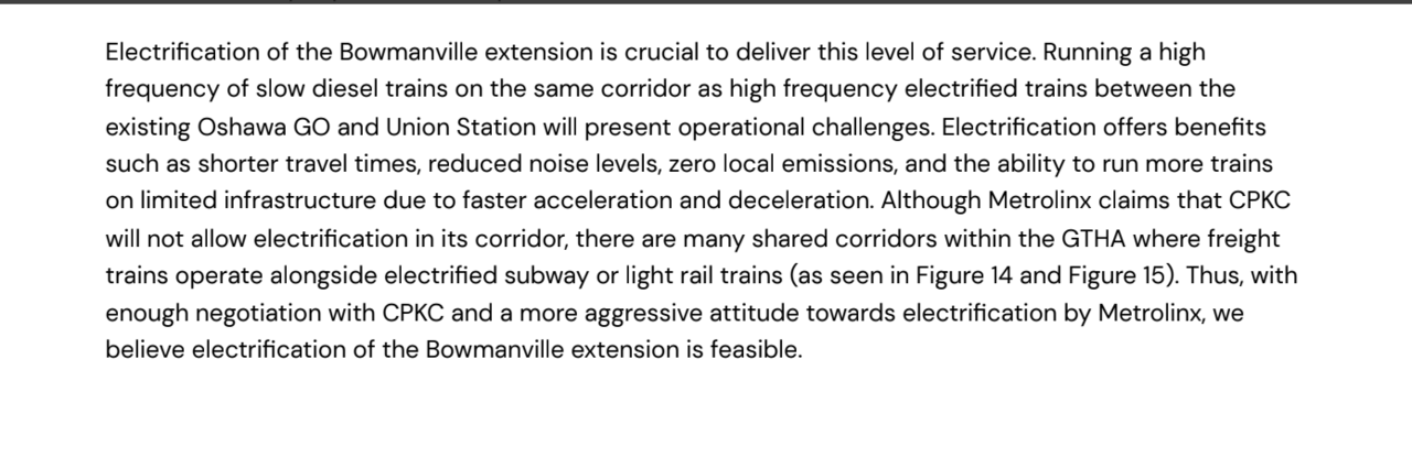

mystery solved: the reason GO Bowmanville is out of scope for electrification is a Metrolinx failure to adopt a sufficiently steely glare when negotiating with CP.
I mean, I hope this is right because if Metrolinx actually adopt this obvious approach, we get also better/electric GO Milton, plus GO Bolton and GO Midtown.

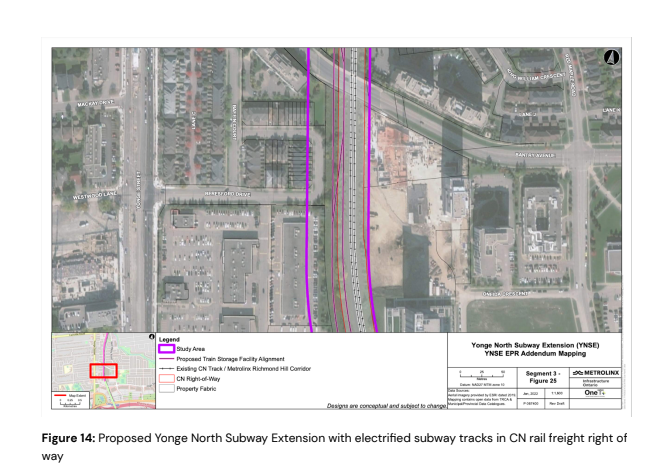

Their Figure 14:
I wonder if CN will insist on a fence between their tracks and the subway tracks, similar to what we see between the subway tracks near Kipling and CPKC.

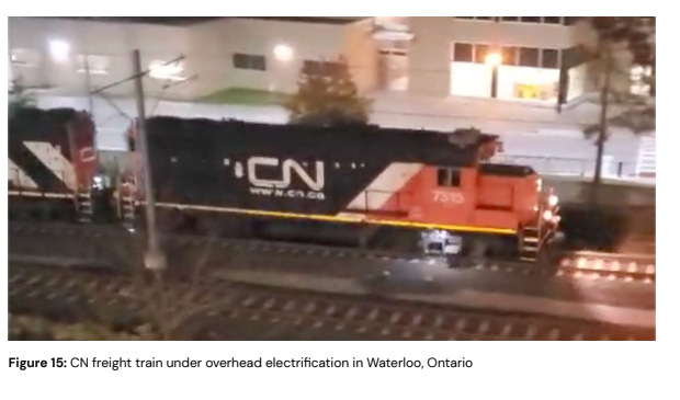

Their Figure 15 is from Waterloo:
I've heard that CN and CPKC's issue with electrification and their tracks isn't so much about wires above freight trains, it's the requirement that crews who work on these tracks need special training and this adds costs and time. It's a bit of an apples to oranges comparison for the Waterloo example because that's a small branchline and not a mainline which is what the CPKC mainline is. They want to ensure that there is no disurption or added complication to their key mainline.
For the Waterloo example given, the tracks don't appear to be owned by CN. Wouldn't it be safe to assume that Waterloo is responsible for the maintaince and the crews?
I'm not saying I fully agree with these arguments CPKC making rather just that it's not as easy as suggesting a more aggressive attitude will solve this. cc @smallspy @crs1026
The Region of Waterloo owns the Waterloo Spur. CN performs maintenance under contract to ROW. CN has trackage rights for freight, and staffs and operates the roadswitcher that runs to Elmira. I believe Keolis and not CN does the maintenance in the LRT zone (I may be wrong on that one)
CN's use of the line is limited to nighttime hours when the LRT is not operating. There is a strict curfew such that CN has to have its train return through the LRT zone and back to Kitchener before the LRT opens. CN serves a couple of customers directly, but one major customer is switched by Waterloo Central Railway because that switching is too time consuming for the roadswitcher to complete before it has to head back to Kitchener. CN is simply hook-and-haul for that customer. CN crews for that one train require special training for the Keolis zone. The point being - CN's ability to operate is significantly constrained, luckily they only need to operate one train a few days a week.
Exactly. There are incentives and disincentives for the host railways that are meaningful. Forcing an unwilling railway into this kind of complex proposition will have consequences - for every action there is a reaction. One has to find a solution that gives maximum incentive and mitigates the disincentives. Only when that is done can one maybe add some pressure.
There are very significant differences in the operating format between the Waterloo Spur and what GO would need on the mainlines. Voltage being one of the items. I don't pretend to understand the railways' exact concerns, but in aggregate it is indeed a headache they just don't need. The fact that it is done in Waterloo does not necessarily set precedent for the main lines.
Their Figure 14:
As far as I know, there are no double stack car using Waterloo line with ION line. CN only moves at night after ION shuts down. Have heard CN working north of the ION line during the day.
Also significant that the Waterloo Spur ops actually de energize the overhead while CN is active.
