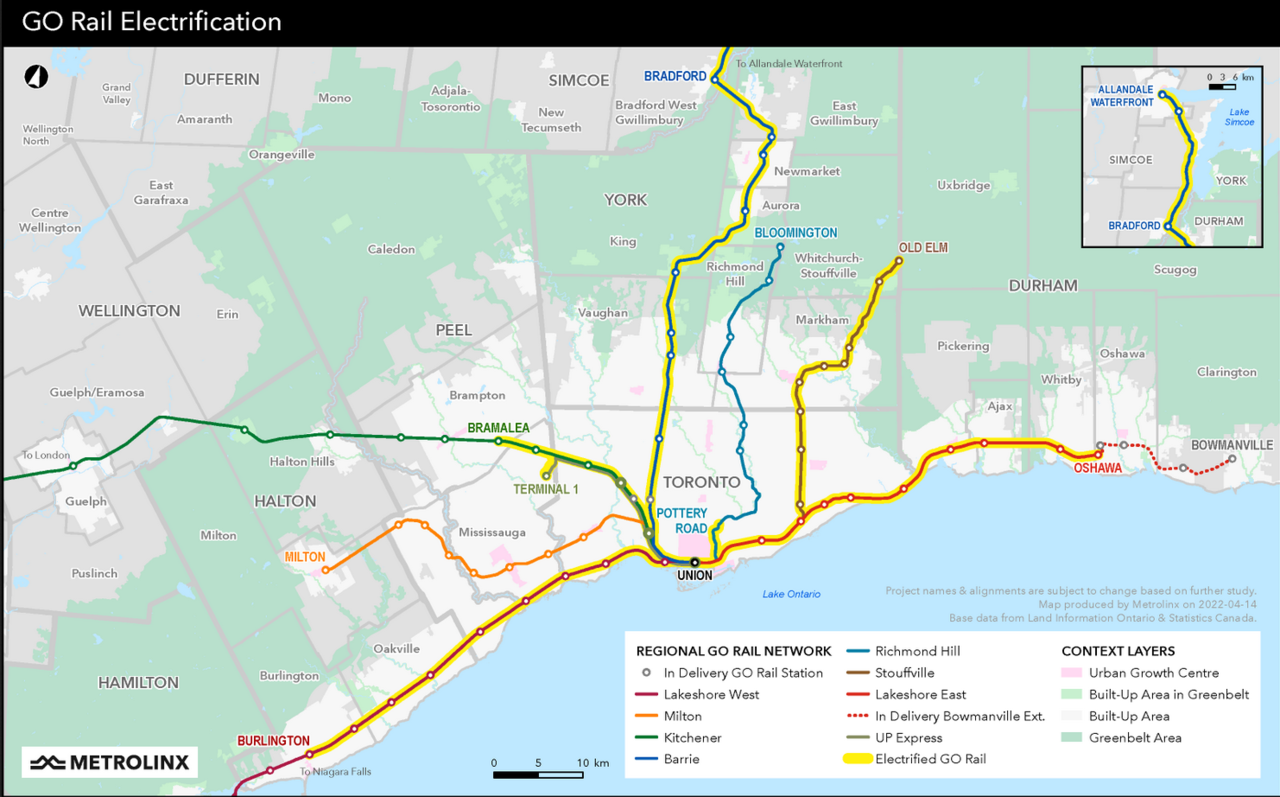

GO Transit Electrification | Metrolinx
I am not busting out the champagne yet - especially when it comes to frequencies. This is just the first part. The entire buildout is supposed to be 10+ billion dollars and 10 years is a long time.

For all those talking about 3.5 minute headways my understanding is this refers to what will be several key quad track sections, like around EX on LSW, LSE / Stouffville, and Kitchener on Gerorgetown south. That lines up with the roughly 7 minute headways we've heard about on dual track lines. So you'd get a 3.5ish min frequency when you consider combined local express service - unfortunately it isn't really organized in a way for that to be useful on most corridors, since we are planning on running the lines together (line running) rather than the directions together (directional running) this let us drop the Scarb Junc grade separation but means you can't just wait on the platform at say Dundas West and catch the next train because it's either a local or express to union, they are unlikely to be on the same island platform.

As much as I want emus we also aren't designing the network for it . . . look at these stop spacings . . .
Tightest will be Mimico to Park Lawn (and not all trains will stop at both I imagine) at like 1km
Union to Spadina is also roughly 1km but only Barrie will stop (sadly)
Union - East Harbour ~2.5 km
Union - Exhibition ~3+ km
Union - King Liberty ~3+ km
Spadina - Lansdowne ~5 km
King Liberty - Bloor Dundas West ~3 km
St. Clair / Stockyards - Bloor Dundas West ~2 km
These stop spacings just aren't subway like, and while the potential to add more stations is there, with the subway network we are building there is less and less need to provide super local service on GO. That can always chance in the future but shorter trains plus electric locos probably isn't going to be that different from EMUs at this point . . .

Regarding headways: Be careful what you wish for regarding very short headways. If your line only has a single track per direction (Barrie, Stouffville, LSE following introduction of line-based running) and your local service is very frequent, you can't have any express services. I for one don't want to be making every station stop en route from Barrie to Toronto.
Regarding EMUs, it is definitely disappointing that there is no talk of EMUs yet, but it is understandable given our massive inventory of well-maintained BiLevel coaches. Starting off simply with electric locomotives is logistically simpler, and the first order of electric locos can operate local services on the central portions of the lines which will be electrified first.
However, following that initial rollout, I hope that DB/Alstom will start transitioning the fleet to EMUs through attrition. New trainsets will be required for expanded service and to replace old BiLevels getting retired. In addition, there are 12 other railways which operate Bombardier BiLevel coaches, and there may be opportunities to sell off a few units here or there. It would be quite cost-effective to fill those needs by having a standing order for EMUs with a few delievered each year as required. As new EMUs arrive, they could displace the electric locomotives on the core local services. Those would be redeployed onto express services as the outer portions of lines get electrified.

Luckily, GO has several parts of it's network which are entirely grade separated (or are planned to be from GO Expansion), and several more which are very close to that level.
- Stouffville from Unionville to Union
- Lakeshore West from Long Branch to Union
- Barrie to Caledonia GO
- Kitchener to Malton GO
- Lakeshore East to Eglinton GO
