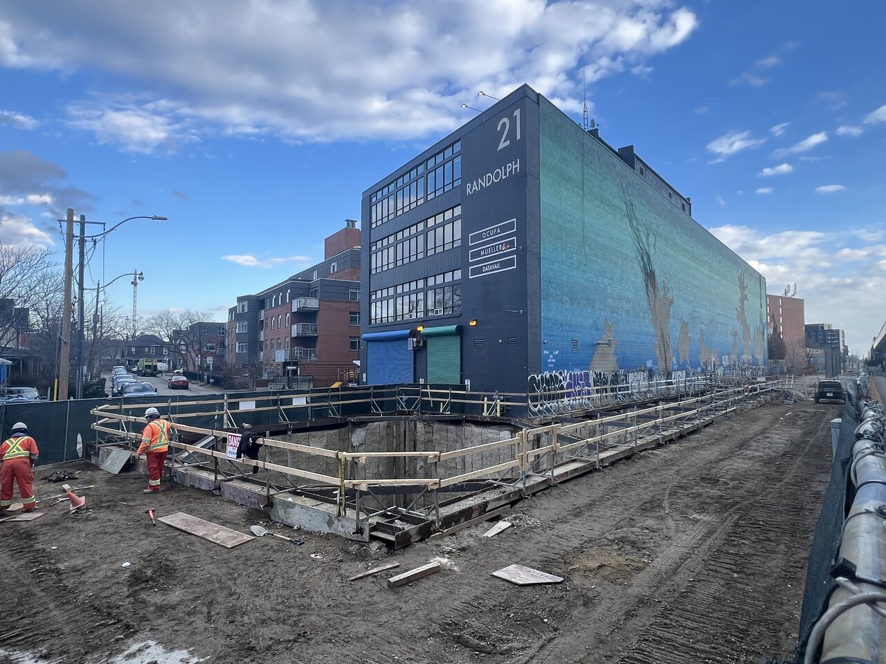

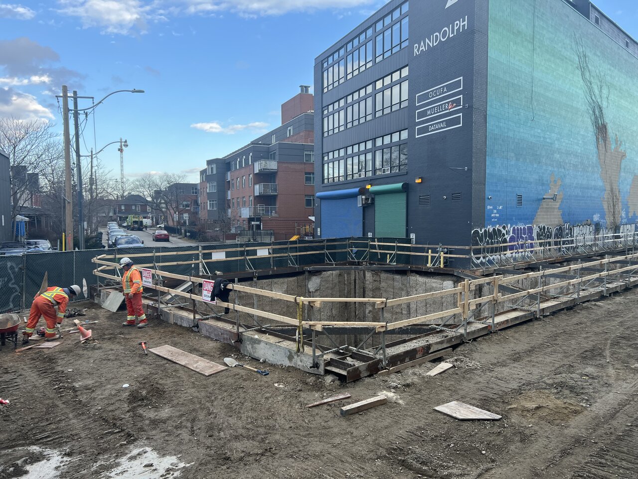

Anyone know what the wood base on the Milton line track is for?
View attachment 540126View attachment 540127View attachment 540128
