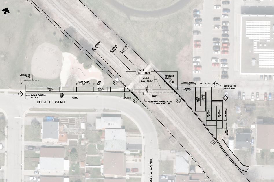

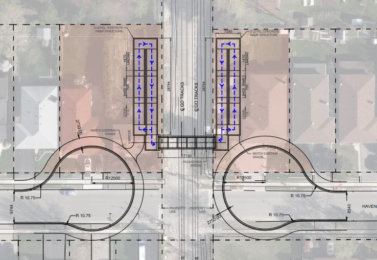

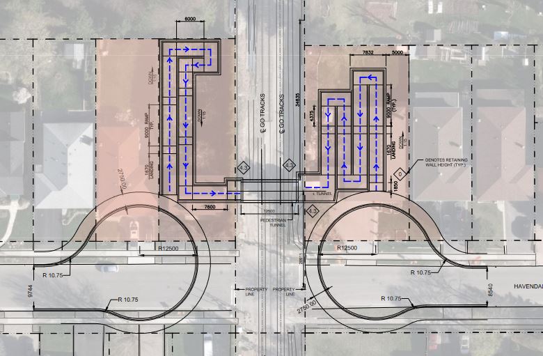

Yeah, the Stouffville Line grade separations come to mind. Their public presentation materials were heavily biased in favour of pedestrian bridges rather than tunnels. For the design precedent images they chose pictures of dingy dark tunnels and shiny bridges, and they disguised the massive increase in vertical & horizontal distance by only showing the overhead view, in which you can't see the number of switchbacks of the bridge option because they're stacked on top of each other. Meanwhile switchback ramps of the tunnel options are not stacked so the full walking distance is clearly visible from the overhead view.
Havendale Road - tunnel option.
Havendale Road - bridge option. At first glance the walking route it appears more direct than the tunnel option, as long as you don't notice the small text reading "3-level ramp structure".
Corvette Avenue tunnel option: I'm not sure why they did so many switchbacks on the east side, rather than starting the ramp downward as soon as the pathway leaves the street.
Corvette Avenue, bridge option (rotated 45 degrees for some reason)
