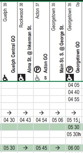

If you look at the peak schedules, that Guelph passing track alone will not enable counter peak service, because the headways will not allow a counter peak train to run Georgetown to Guelph without doing some additional passing. Same with Guelph-kitchener. Apparently, additional sidings are in the works. I was told procurement for these is also imminent, not sure if it’s one big tender for all the work vs multiple.
It’s happening, one step at a time. But full double tracking is a long ways off.
True, the Guelph siding alone isn't enough to get counterpeak service past the 30-minute peak service, but combined with a passing opportunity at Georgetown it's enough for hourly off-peak service in both directions, given that Guelph and Georgetown are precisely 30 minutes apart.

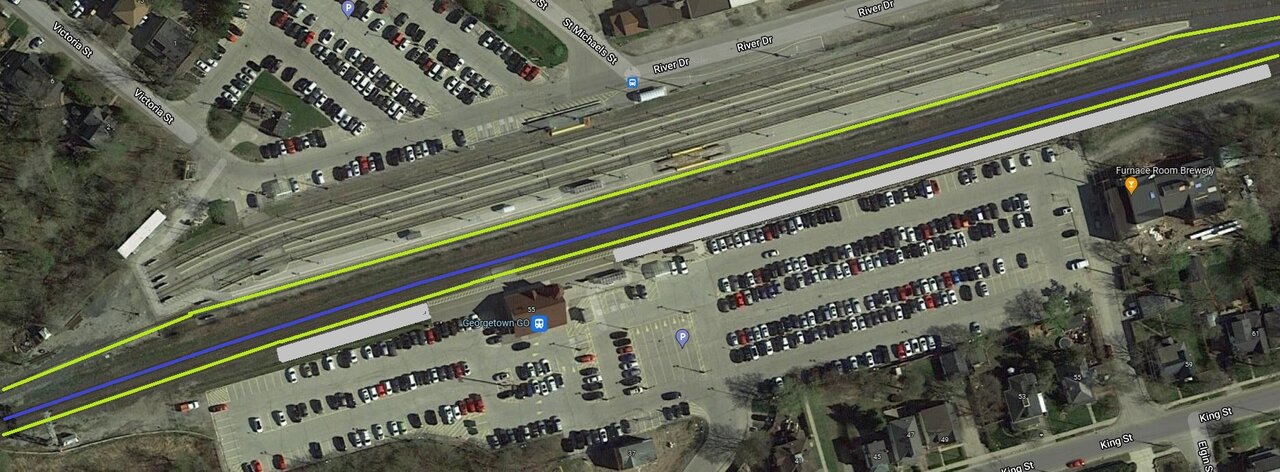

In the meantime, it seems like we could make a quick-and-dirty passing location at Georgetown simply by lengthening the south (VIA) platform to support GO trains. The existing track configuration would allow the eastbound and westbound GO trains to cross CN traffic simultaneously there, operating on the south track east of the station. This leaves the remaining 50-minutes per hour free for CN trains to pass through. The Kitchener line business case implies that CN has agreed to hourly GO service with this type of operation, even prior to the flyover being built.

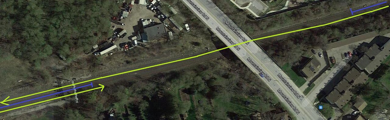

West of Georgetown, the Metrolinx Guelph subdivision joins into the CN Halton Subdivision from the north - eastbound trains would cross over here to reach the south CN track. Westbound trains would stick to the GO track on the north side of the corridor.
There seems to be enough space to lengthen the south platform to GO's standard length of 314 metres. Eastbound and westbound trains would meet here.

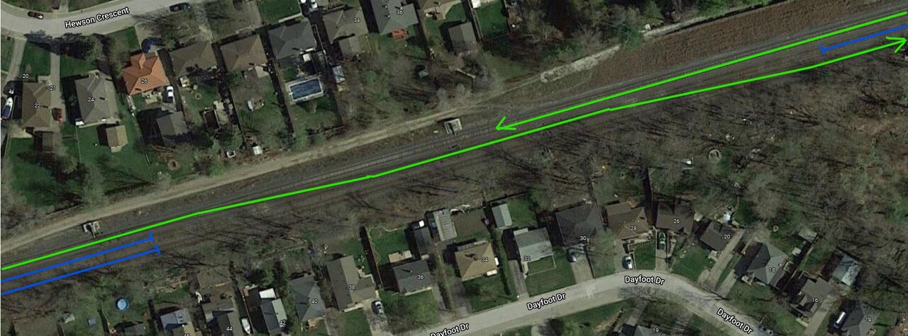

East of Georgetown, GO would operate on the south track in both directions, avoiding any further conflicts with CN. The Metrolinx Weston subdivision splits off to the south at Bramalea.
Given how quick it would be to lay down a temporary platform extension at Georgetown, I figure that hourly midday service could begin as soon as the second platform at Guelph station is complete.
As for counter-peak service, Metrolinx has also stated that they will build a passing track at Acton, which would then provide sidings every 15 minutes along the line. There is already a passing track 15 minutes west of Guelph, located just east of Kitchener Station. That would allow an hourly counterpeak service to meet the half-hourly peak service.

When I rode the train to and from Kitchener last week, the train was no longer switching at Georgetown but instead switched tracks at Norval (just west of Mount Pleasant). As well track 3 at Mount Pleasant is now a throughput track.
The "plan" has changed so many times I have lost track of what lies ahead. But fundamentally, you are correct - the southmost track (South Main Line in CNspeak) could serve as a GO platform as well as a VIA platform. The "If" is whether CN would allow two trains to meet in a way that ties up one of their main lines every hour.
The odd thing that limits operations currently is that the GO platform track has an unsignalled segment. This forces the signals governing entry to the existing GO platform to display speed-restrictive indications even when the track is clear. After stopping, trains must maintain that low-speed creep until they reach the next signal. If that were corrected, GO speeds would improve. And if power switches were added, GO could have a two-track passing area in its existing station. That's not all that expensive an upgrade.
The flyover BCS suggested that a meeting point west of Georgetown station was needed. That makes sense to give a couple minutes' contingency, and it keeps the meets off CN's turf.
