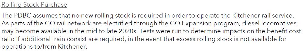

On page 58 of the aforementioned Kitchener Business Case document from March 2021, they anticipate a "mid to late 2020s" start of electrified service:
That caught my eye, and I really wondered if that was completely valid. Certainly some additional equipment might be needed to deploy counter flow service at peak, and to achieve 15 minute headways east of Bramalea, but it may be double counting existing equipment that otherwise heads to layovers.
The purpose of that paragraph appears to be to test financial indices if in fact new equipment had to be procured. I would not read that to say that full service can’t begin until electrification happens somewhere.... and in fact, if the Bramalea portion were among the first lines to be electrified, the equipment currently used for that part of Kitchener service might be redeployable.
It does highlight why electrification needs to be expedited.... so that whatever EMU fleet GO procures arrives soon enough to offset end-of-life for the bilevel fleet. In a perfect world, all of GO’s future equipment purchases would go towards electrification, and would happen at the rate necessary to deploy bilevels without running short of these.
So this is the “commercially more astute” decision that Phil Verster was referring to in his interview with Reece Martin? Instead of having to build a bypass they can add some passing track? Correct me if I’m wrong, but this still doesn’t allow the whole line to be electrified, correct?

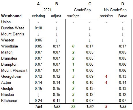

To examine how a fast VIA service could fit into the single-tracked line, I reverse-engineered the schedule that GO is assuming for the AD2W - no grade separation scenario (the scenario which has been funded).
The report is pretty light on details, but they did drop enough tidbits to piece together a schedule:
- The travel time will be 98 minutes, of which 8 minutes is extra padding to accommodate the meet at Silver Junction [page 51]
- The basic hourly service will meet at Silver Junction while and simultaneously cross between the Guelph Sub and a south platform at Georgetown Station [page 19]
- Additional platforms will be built at Guelph and Acton stations [page 45]

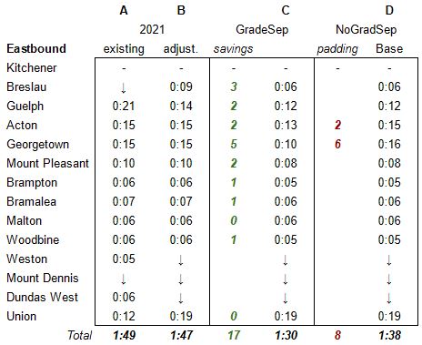

So to work out the station-to-station times, I started with the 2021 schedule (column A in the image below), and translated them to the proposed stopping pattern by assuming two minutes saved per stop skipped (column B). Then I reduced the travel time to 90 minutes by allocating 17 minutes of travel time savings to the segments I think there is the most potential for improvement (column C). Finally, I added back 8 minutes near Georgetown station (column D).
I placed down an eastbound trip arbitrarily, and then repeated it every hour to represent the "base" hourly service. Westbound trips depart Georgetown 3 minutes before eastbound trips, so that they meet at Silver as described. Based on the travel times, this reveals that the hourly base services will also meet just west of Guelph Station. Hence why GO is building a second platform there.

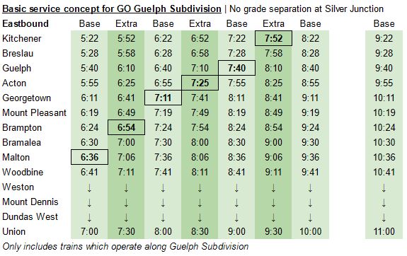

The second hourly service during peak periods (which I'll call "extra") will meet the base hourly service using the siding at Acton, which I'm assuming will stretch west from the station to position the meet as centrally as possible between the Guelph and Georgetown sidings and thus produce headways as even as possible. Based on the travel times, these extra trips will also encounter the base service just east of Kitchener Station, at a location which is already double-tracked.
Here's the AM peak schedule. I have highlighted the places where eastbound trains meet the first westbound train. The travel times involved some guesswork so they won't be exactly right, but since the end-to-end travel time is correct, the errors should cancel out and the individual station departure times should be within a couple minutes of GO's assumed timetable.

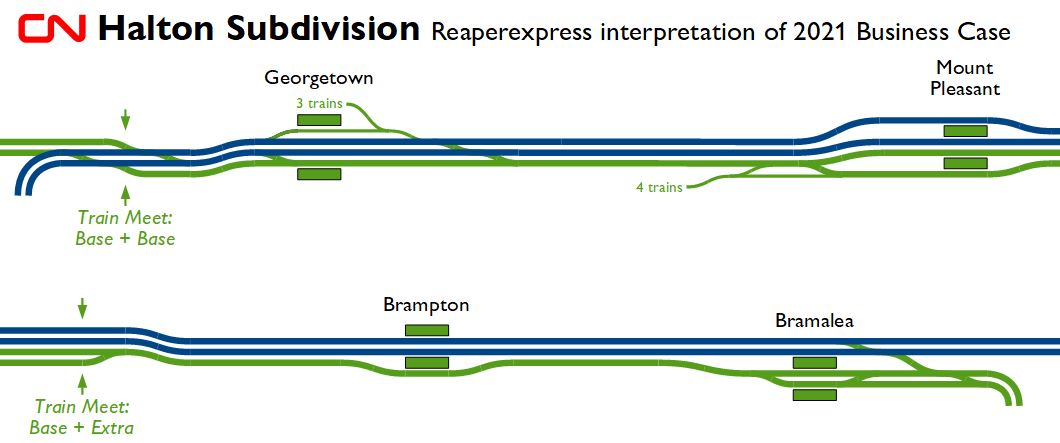

Given the above, here's my guess as to where tracks which will be added to the Guelph Subdivision:
Existing infrastructure in black, new infrastructure in red:
The "Extra" train path would be the one used by CN and VIA trains, during hours it's not being used by GO. Regardless of the type of service using the path, the time in Acton is set in stone because the trains need to meet the base service in a (presumably) short siding there. So variations in travel time between service types need to be accommodated at the adjacent meet locations.
VIA trains skipping Breslau would be a few minutes faster than GO trains, so their next meet to the west would occur further west than with Extra GO trains. That's fine because the new Kitchener Central station will have two platforms (plus future-proofing for a third). Incidentally, this means that we know the platform assignments at the future station: the base service will use the south platform next to the station building, and the VIA and GO "extra" services will use the north platform. That also works out nicely given that all the GO Extra trains will be heading in or out of service, and both of the yards in Kitchener are located on the north side of the corridor.
The meet between CN and the base GO service will be further east given CN's lower average speed. As a result, I suspect that the existing double track in Kitchener may need to be extended somewhat to the east to accommodate this meet.
The next meet to the east would normally occur just west of Brampton Station for GO Extra trains, so GO will presumably fund a new passing track there. It's harder to predict where the new passing tracks will be located along the Halton Sub since trains can technically pass anywhere, but I'm guessing the end result will be something along these lines:
Tracks coloured by primary track user (not necessarily track owner). Green = GO, Blue = CN
The "Extra" path is occupied by GO during all times of day, so VIA will need to use one of the "CN" tracks through the corridor. If VIA skips Georgetown Station, they should have enough of a speed advantage to overtake that GO train and pull in front of it east of Bramalea. Then VIA would have a relatively clear shot down the express tracks of the Weston Sub.

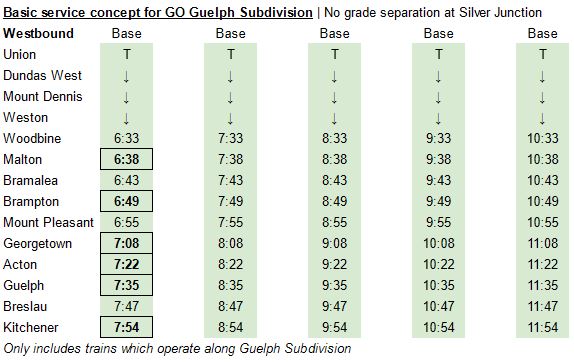

Here's my take at a plausible VIA schedule (in Yellow), with meets highlighted:
The schedule includes 2 extra minutes due to the meet in Acton where the train will typically need to stop and wait for the oncoming GO train, but Acton would not be an official station stop. That way, if the VIA train is behind schedule it can pass through at full speed. By then, the GO train would already be waiting in the siding.
The bottom line is that it does thankfully look possible for VIA to run significantly faster than GO through the corridor, as long as they can negotiate a good train path with CN. The only significant slowdown is that they need to pause at Acton to meet a GO train.

Reading the report (p.50), trains in opposite directions meet at Georgetown GO, not west of Georgetown GO. Therefore, the departure time in both directions at Georgetown GO should be the same.
There are benefits in meeting at Georgetown GO as the train can choose to crossover the CN tracks before or after the station, which increases the chance of a clear crossing path. Here is an oversimplified diagram:
^@Haydenpoon’s layout would allow an eastbound GO to wait at the north platform for the westbound to arrive at the south platform, or the westbound to wait on the south side for the eastbound to arrive......then both trains could cross over simultaneously, minimizing the interruption to CN.. I think this is the most likely layout for the no-overpass scenario. One could envision fixed (diamond) crossings as opposed to turnouts being used to cross CN.
The added 8 minutes in this option reflects dwell time for both trains in the station, partly to ensure both trains are ready to cross together, and also possibly to give time for any CN train that was already passing to clear the crossovers.
The fly in the ointment would be the need for eastbound CN freights to hold west of Silver if the GO trains were lined. This would block a couple of very bust road crossings, and potentially stop the freight on a grade. I suspect CN would be happier to have the crossing over happen at the Georgetown crossovers, a little further east and with any held-up eastbound trains a bit less hampered by grade.
