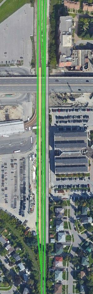

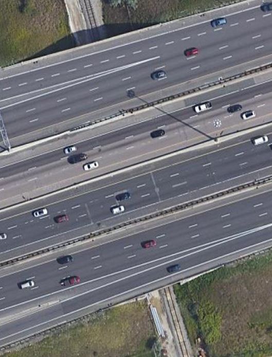

The reason for the two-track bottleneck between Lawrence and the VIA junction is the 401 underpass which (as far as I can tell) can only fit two tracks.
Of course anything's possible if we throw enough money at it, as we saw when the Kitchener Line ran into the same obstacle.
It looks like it might be practical to bring the southbound track further south, on the west side of the west platform at Kennedy. That would help reduce delays for the local train taking the siding.

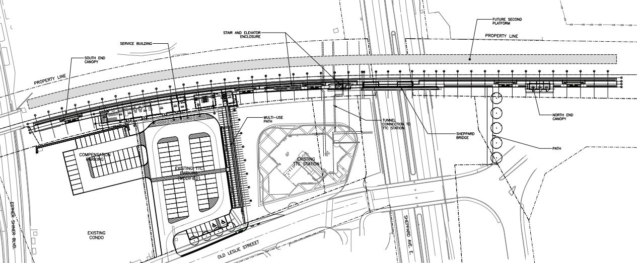

To avoid cluttering the OL thread that's gone off topic:
The Oriole upgrades is less of an upgrade and more of a northward shift so that the station has a proper connection with Line 4. Its not slated to happen any time soon, and is instead something that will probably happen alongside the extension of Line 4 east to meet Line 2.
Isn't Oriole planned to be relocated fairly soon--I recall hearing it would be within the next few years. Or possibly bundled with the current work on the Leslie-401 ramp?
I was under the understanding that the Oriole move was required to rebuild the 401 bridge over Leslie - which is happening very soon. I recall Metrolinx going as far as filing a site plan application for the new station and everything.
Yep. It's filed under the address 2760 Old Leslie Street. Here's the application timeline, from the City website:
I can't seem to get a static link for that application's home page, but if you search that address in the City's Application Information Centre, you can find links to architectural drawings for the new station.
