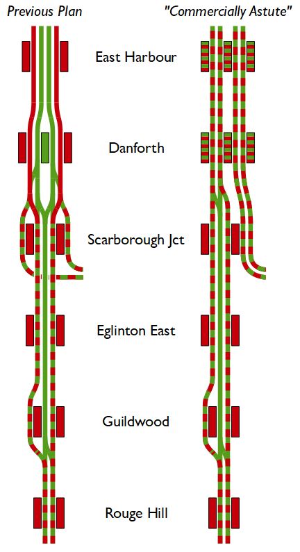

Here's my take at illustrating the changes he described: no more grade separation at Scarborough Junction, and an extra platform at East Harbour.
Rather than a single quad-tracked line with services sorted by speed, there are now a pair of double-tracked lines. This creates a problem for express trains, since they can no longer overtake local trains. This is the real reason that Verster's new plan has express trains stopping at East Harbour: they're stuck behind locals anyway so they might as well stop.
On the Lakeshore corridor, there is a pre-existing triple-track segment between Scarborough Jct and Guildwood, so there's plenty of room for peak-direction express services to overtake locals. But if we want express service all day in both directions, we're in trouble. In the absence of passing tracks (e.g counter-peak), the speed of the express services is dictated by the frequency of local service. With local service every 15 minutes, express services can only be about 7 minutes faster than the local. I'm assuming a minimum scheduled separation of 4 minutes, based on the schedules here in the Netherlands. So the express departs 11 minutes behind the local, and by the end of the shared segment it's 4 minutes behind.
Even with moving-block signaling which allows trains as close as 60 seconds, a single shared track would still only allow the express to be 9 minutes faster than the local. But realistically we'd want express services to skip 5 or 6 stops between Union and Pickering, which would make them 10 to 12 minutes faster than the locals. And VIA trains are even faster still.

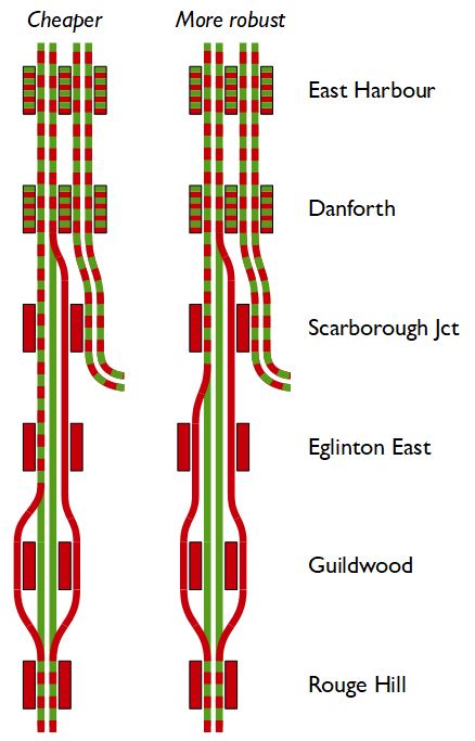

So if we want all-day express service in both directions, we need to build some additional passing opportunities. The cheapest option would be to simply add a fourth track at Guildwood station. The station's reconstruction a few years ago already built the structure and platforms for a fourth track, all that's missing is the track itself. But the downside of having a one-station-long passing track is that the local trains would need to sit for 2-3 extra minutes to allow the following express train to catch up. This delay can be resolved by extending the passing track to include another station. In the diagram below, I show the track being extended to Eglinton GO, but extending it to Rouge Hill would work as well.
The Stouffville line doesn't have any passing opportunites at all for express trains, so given that local service is proposed to operate every 10 minutes, express service is now physically impossible. In the previous design, express trains could run non-stop from Kennedy to Union.
Rather than a single quad-tracked line with services sorted by speed, there are now a pair of double-tracked lines. This creates a problem for express trains, since it is no longer possible to overtake local trains. This is the real reason that Verster's new plan has express trains stopping at East Harbour: they're stuck behind locals anyway so they might as well stop.
On the Lakeshore corridor, there is a pre-existing triple-track segment between Scarborough Jct and Guildwood, so there's plenty of room for peak-period express services to overtake locals. But if we want express service all day in both directions, we're in trouble. In the absence of passing tracks (e.g counter-peak), the speed of the express services is dictated by the frequency of local service. With local service every 15 minutes, express services can only be about 7 minutes faster than the local. I'm assuming a minimum scheduled separation of 4 minutes, based on the schedules here in the Netherlands. So the express departs 11 minutes behind the local, and by the end of the shared segment it's 4 minutes behind.
But realistically we'd want express services to skip 5 or 6 stops between Union and Pickering, which would make them 10 to 12 minutes faster than the locals. Even with moving-block signaling which allows trains as close as 60 seconds, a single shared track would still only allow the express to be 9 minutes faster than the local.

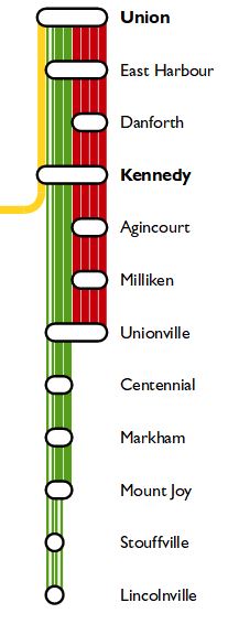

Additionally/Alternatively, if the GO local service runs every 15 minutes instead of every 10 minutes, there would be enough room for VIA to run between local services without being held up. As previously mentioned, 15 minute local service leaves about 7 minutes of room for "catch up", and VIA actually only needs 4-5 minutes for the short stretch of the corridor they'd share. Here's a pretty extensive service concept which would fit on a pair of tracks (plus a siding at Unionville for turnbacks):
In this scenario, VIA services are 4 minutes faster than local service between Union and Kennedy, and GO express services are 6 minutes faster than local services between Union and Unionville.
One of the ways for Express trains to overtake in between Union and Unionville is to quad track using the SRT right-of-way soon to be demolished between Eglinton and Ellesmere. It also means GO can add two more stations in the current Lawrence East and Ellesmere SRT station.
