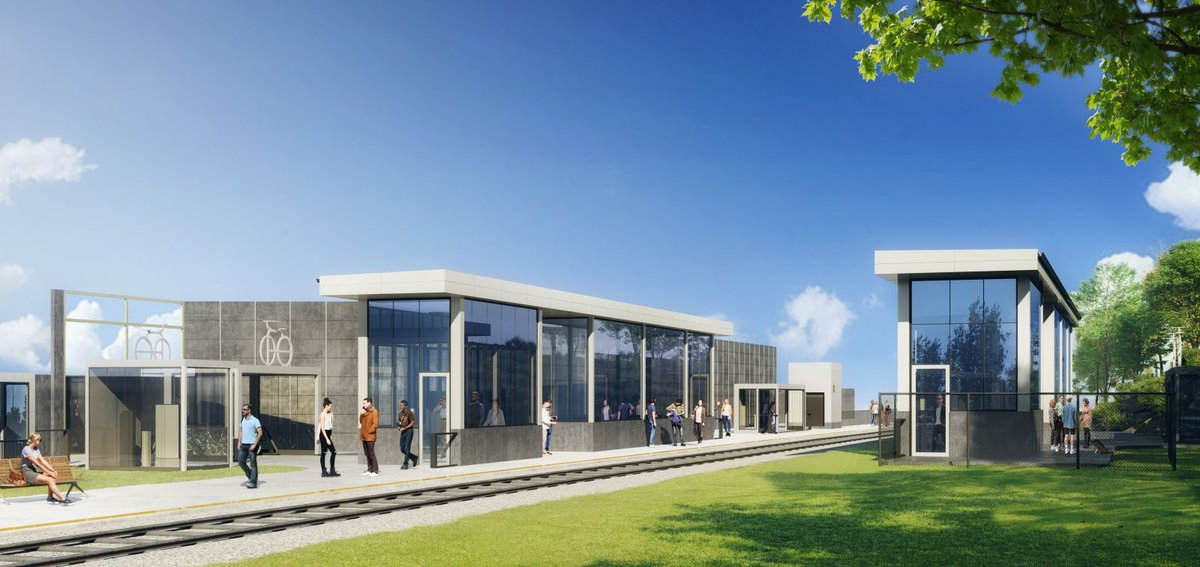

Caledonia GO Station news today that construction "has started".
Looking at the track level render, it looks like they are building another shelter on the other side of the tracks to accommodate double tracking at a future date. Which may be one day. Probably.
I'm assuming the "shelter is the tunnel entrance? I hope it's a tunnel entrance anyway. It will make an excellent connection to the Beltline.

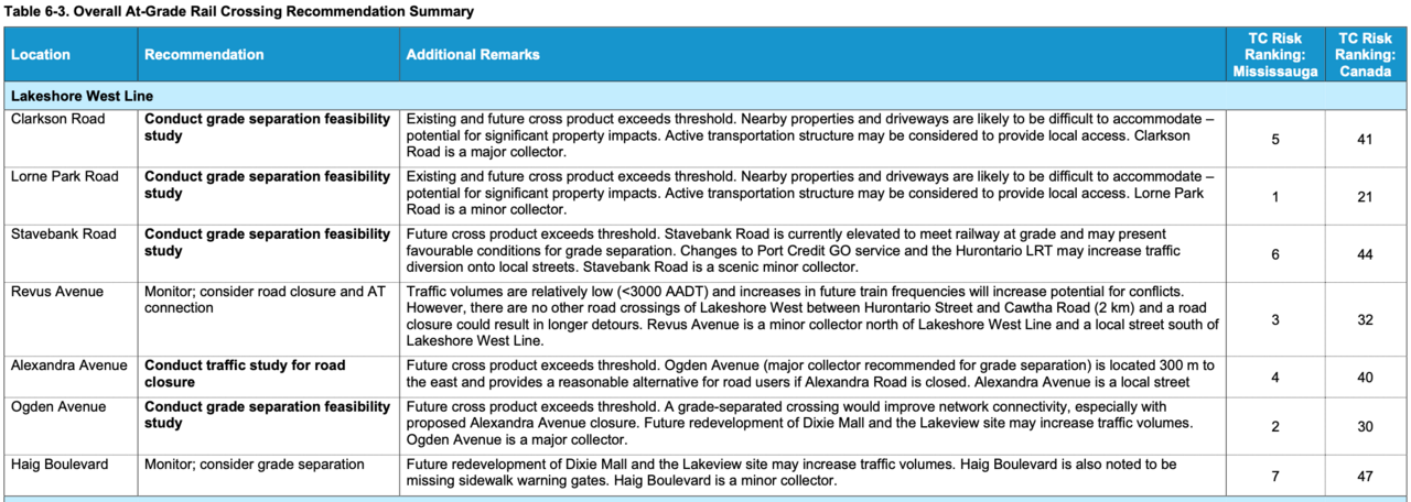

So the crossings other than Clarkson, Lorne Park, Stavebank, Ogden and Haig would be closed, presumably?
I see Revus Ave. and Alexandra Ave. nearby, specifically.
Here is the technical report on grade separations the city used to develop the TRIP. The technical report is a couple years old now, and I think parts of it have been posted here before.
From the Lakeshore West section of that report:
Also, this is just Mississauga's report. Presumably, the province has its own report. I could see the province not wanting to grade separate Stavebank or Haig.
The federal grade crossing elimination program provides somewhere about $12-13m a year for grade crossing work nationwide, and doubtless that bucket has not been supported to anything like the level of construction inflation. That funding bucket should be significantly increased and a massive increase in the single-project cap. I would also consider that an auto insurance levy should be considered (disbursements on the basis of fed/prov/muni cost share) given that presumably improvements in dangerous road crossings reduces the incidents of claims.
I don't know how the insurance industry would react to that, but from GO's perspective, Mississauga's technical report is out of date.

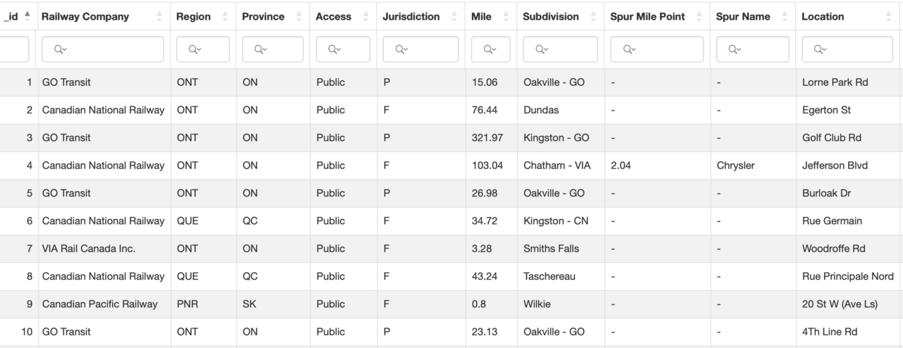

According to the latest Transport Canada rankings, Lorne Park Road is now the riskiest at grade crossing in the entire country. This ranking is based on combined road and rail traffic levels, road and train speed, number of tracks, etc. 3 other GO crossings make the top 10 riskiest, and 11 GO crossings are in the top 20.
I wonder if that isn't too aggressive in keeping roadways open. Given that GO Expansion (and Mississauga) are lacking in money, I'd rather they close everything except Lorne Park and Ogden and put up AT connections instead.
(non-)Bridge dream? Too aggressive?
According to the latest Transport Canada rankings, Lorne Park Road is now the riskiest at grade crossing in the entire country. This ranking is based on combined road and rail traffic levels, road and train speed, number of tracks, etc. 3 other GO crossings make the top 10 riskiest, and 11 GO crossings are in the top 20.View attachment 687349
I see that Scarborough Golf Club Road is number 3 - I've long had a fantasy of Metrolinx realigning that portion of the line along with the grade separation to eliminate the current 75 mph (121 km/h) speed restriction, raising the speed to the 95 mph (153 km/h) limit along the rest of the line. But as we know, Metrolinx has no interest in operating fast services nor improving Ontario's intercity services so that would definitely never happen.
Totally agree. Stavebank especially makes no sense for a motor vehicle grade separation. On top of being several times more expensive than an AT-only grade separation, maintaining car traffic at that crossing would undermine Missisauga's ability to affordably create safe, efficient and comfortable AT routes to downtown Port Credit from the north.
Stavebank's QEW crossing is already AT-only, so the road is not a through route for cars anyway.
The only people who drive across the railway at Stavebank are people who live within walking distance of downtown Port Credit, or people who are shortcutting through that residential neighbourhood. If the railway crossing is made AT-only, through traffic on Stavebank would be eliminated, turning it into a safe and comfortable street for AT without needing to build any dedicated AT infrastructure along it.
Which is good because adding sidewalks and cycle tracks on Stavebank would be very challenging:
Stavebank forms a very direct route to downtown Port Credit and Port Credit Station from the north, so it could become a very useful cycling connection.
