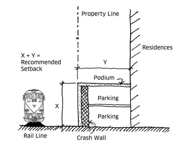

The Canadian standard is 30 metres from edge of the property line shared with the rail corridor, with caveats:
1. Can be reduced by a crash wall (typically by 5m)
2. Can be measured horizontally and vertically
3. "low occupancy space" can be constructed within these areas - i.e. parking, storage areas, etc.
This is the full guideline for details. There are further nuances to it than that, but that's the general idea.
In the case of 6 Dawes, they built a crash wall, which reduced it to 25 metres, then filled that 25 metre area basically entirely with low-occupancy space (i.e. parking) until they got 25 metres up vertically, where the units start.
A key piece here is that it is a guideline, not a hard and fast rule. With the proper negotiation and other mitigating factors it can be reduced. Also, one silly thing about this standard is that it's designed for freight trains. The standard should in practice be reduced on passenger-only lines.
Yes. And alas from my experience, Metrolinx likes to hold pretty close to the standard in negotiations, as silly and overly stringent as they are.
In this case a 25m setback was applied because they did provide the crash wall:
However Metrolinx did seem to allow a bit of flexibility on the definition of "low occupancy uses", with building lobbies, retail, amenity areas, and a small area of the daycare actually being located within the setback. No residential units are located within it.
ANX, Bianca, 500 Dupont, The Dupont, Fuze / Fuze 2, The Dimond, and The Spoke all feature this set up as well. Funny enough, part of the reasons 328 Dupont, in its original form, failed at OMB was because it didn't follow this format.

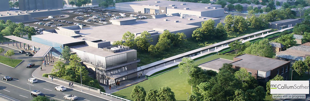

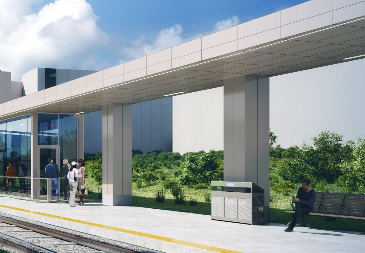

Crazy that they're only building a single track and platform on a line where construction is currently underway to continuously double-track the line from Union to Aurora.
Looking at the track level render, it looks like they are building another shelter on the other side of the tracks to accommodate double tracking at a future date. Which may be one day. Probably.
They have pretty much completed the subgrade and noise walls for double tracking from Davenport all the way north to Steeles.
It's somewhere between ominous and outrageous how they are maintaining radio silence on actually completing the double track.
Sure looks like the plan is on hold.
