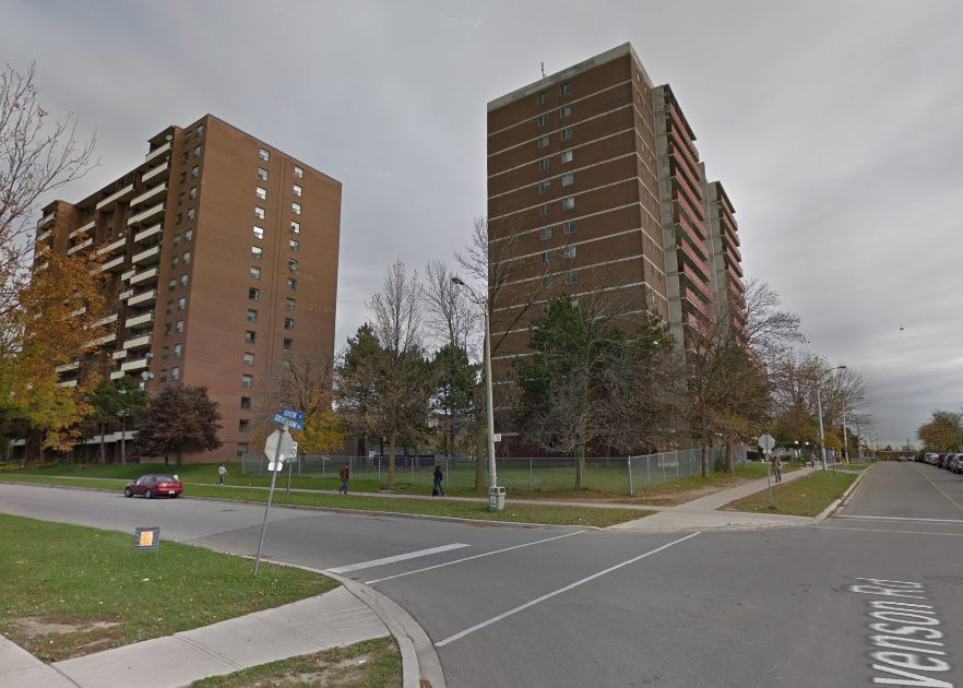

Stevenson:
Chosen likely for 3 factors, the mall to the south, but this, as noted prior is served by 2 other stops.
But the stop also directly serves these 2 residential towers:
It also serves a Junior High just up the street that is ~290M from Finch.
So the impact of removing the stop is taking the distance for the residential ~ 25M and the Junior High and considering the distance w/o that stop.
Distance to Kipling : ~710M (school); 430M for apartments.
Distance to Albion: ~560M (school); 332M for apartments.
I think there's a reasonable case for removal here, the primary impact is on the middle school which is material, but likely represents a fairly low portion of any potential ridership.

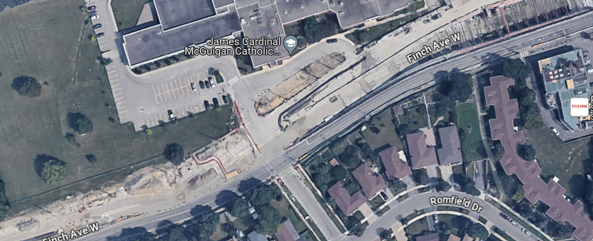

1. LRT should have resurfaced after passing Romfield Lane. It would allow the LRT to bypass traffic lights and avoid unnecessary delays. From here the LRT would run surface level to serve the local community,
2. The next big and expensive change would be to remove the Driftwood Ave stop and bury the Finch West LRT between Jane and Weston. The LRT could have entered a trench before driftwood to avoid that traffic light. My logic here is Finch West during rush hour is packed with cars and having the train run surface level here increases the chances of delays due to traffic and accidents. If the LRT ran unground in this section the trains could travel fast. The stops would remain the same with stops at Jane, Norfinch/ Oakdale, Signet/ Arrow, and Weston. The LRT could have resurfaced after passing Jayzel Dr, avoiding another traffic light, and run surface level to serve the local community.
3. Now for a smaller change I would have removed the stop at Duncunwoods Dr.
4. After passing through Pearldale Ave. the LRT could have gone through an above-ground section with an above-ground station at Islington. Between Islington and Kipling the lrt would run along the surface
4. lastly the LRT would go below grade between Kipling and Albion to avoid those busy intersections. It could have been built similarly to the Mississauga Transitway to keep costs down. Also, Stevenson station would be removed. After Albion, the LRT would resurface and run above ground.
My logic overall is the LRT would run separately at busy intersections, but serve more local trips between the major intersections. You would get both speed and convenience. hopefully satisfying both parties in this debate.

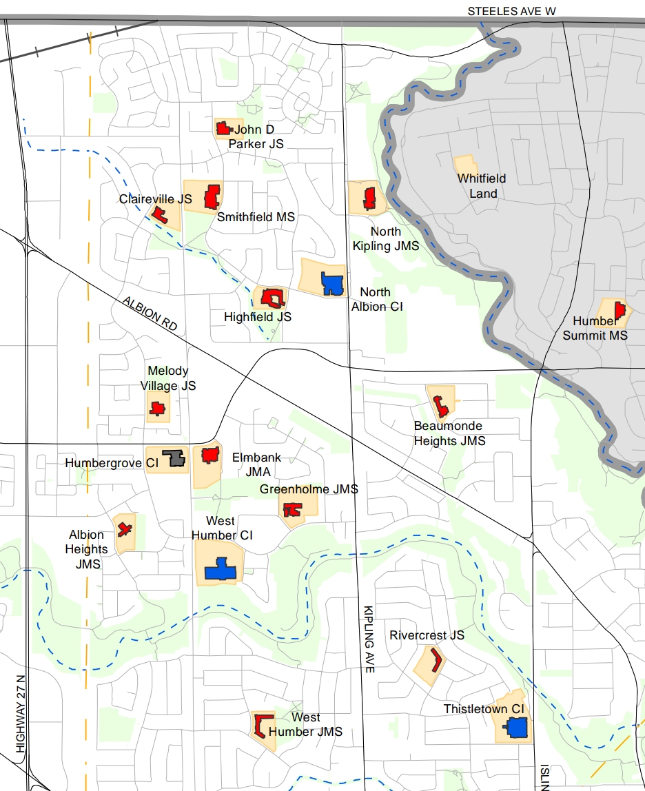

So, Highfield Junior School is a K to 5 school with just under 600 students. Considering the proximity of other junior schools (elementary), the catchement area must be small.
