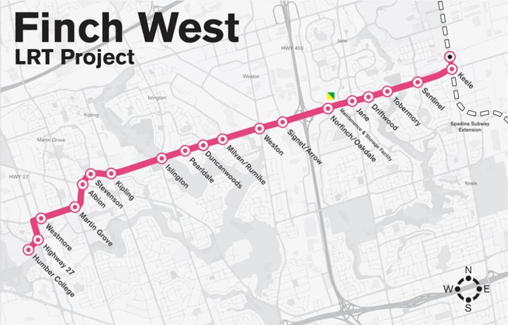

I've talked with quite a few people about this, and in general we came to one general conclusion.
1) Stevenson should be cut
2) Driftwood as well
3) Out of Milvan, Pearldale, and Duncanwood, choose 2/3 (Probably Milvan and Pearldale).
Its worth noting however that the map is outdated, as I'm pretty sure they nixed the stop at Highway 27 long ago,

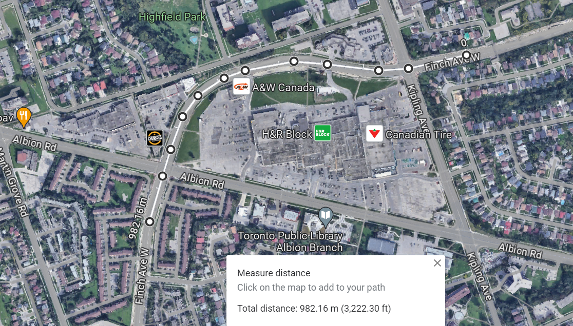

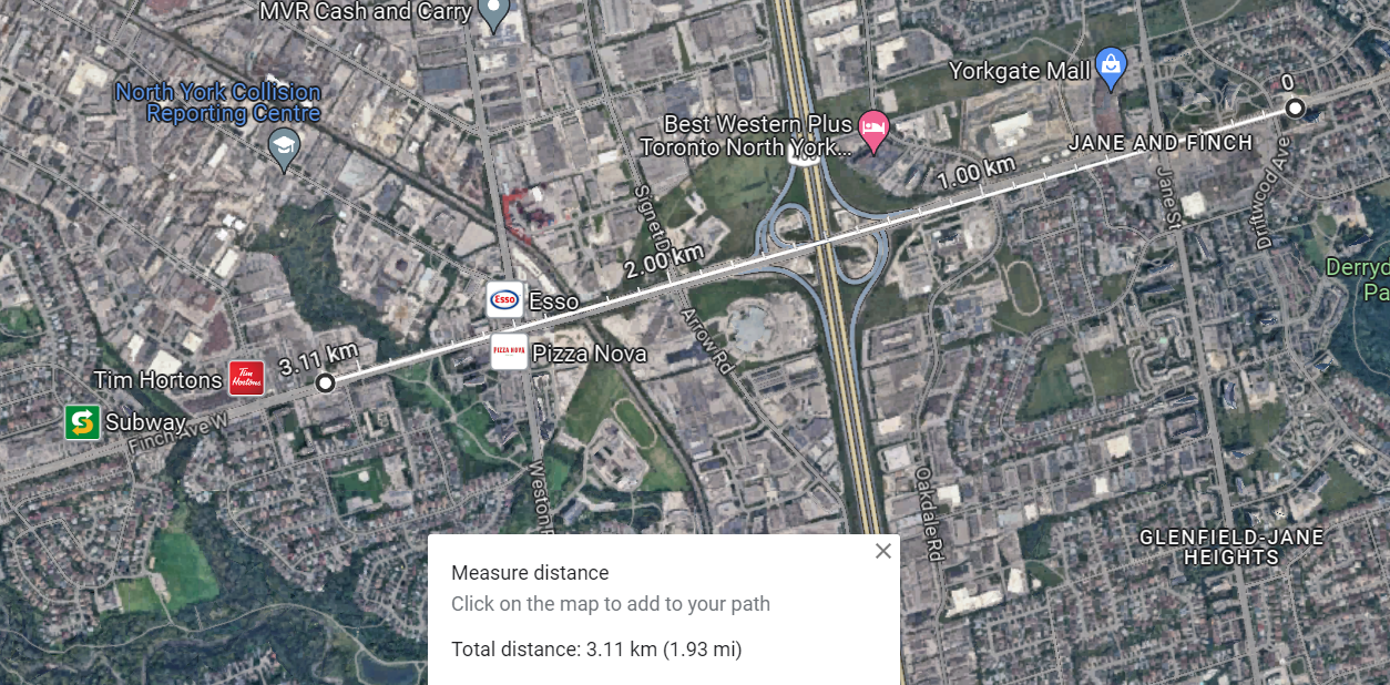

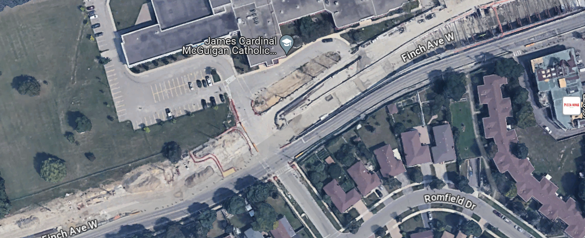

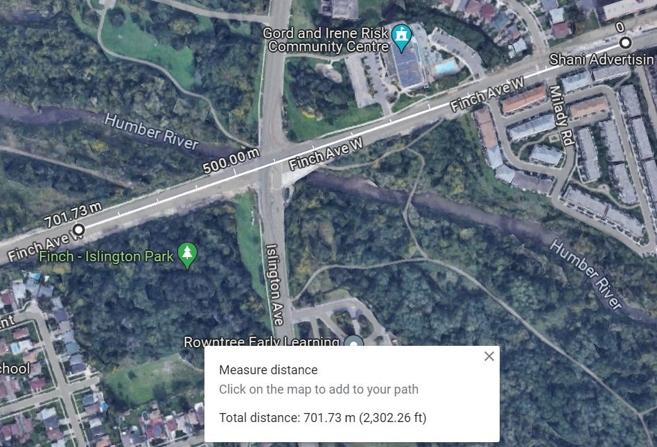

If we had unlimited money there could have been a better way to design the Finch West LRT which would have improved speed but still serve the local community.
I'm inclined to agree with @chrisw above; if we're wandering off into wild fantasy territory by vastly increasing the budget, then it suddenly becomes why not a subway to every door?
1. LRT should have resurfaced after passing Romfield Lane. It would allow the LRT to bypass traffic lights and avoid unnecessary delays. From here the LRT would run surface level to serve the local community,
You're looking at adding ~250M of tunnel, so probably an added 250M; that's a big chunk of change; I'd have to see how substantial the delays caused by this light are; and whether one might not be better off removing the light, and making the intersection right-in, right-out for a lot less money.
2. The next big and expensive change would be to remove the Driftwood Ave stop and bury the Finch West LRT between Jane and Weston. The LRT could have entered a trench before driftwood to avoid that traffic light. My logic here is Finch West during rush hour is packed with cars and having the train run surface level here increases the chances of delays due to traffic and accidents. If the LRT ran unground in this section the trains could travel fast. The stops would remain the same with stops at Jane, Norfinch/ Oakdale, Signet/ Arrow, and Weston. The LRT could have resurfaced after passing Jayzel Dr, avoiding another traffic light, and run surface level to serve the local community.
2.5 km of tunnel/trench is going to literally double the project budget.
A trench is not viable and/or hugely expensive, in many sections along the route; every road that crosses said trench would sit on a bridge, in essence; and going under the 400 would mean rebuilding the entire interchange; stations/platforms add width beyond the core trench, and now that you're underground, you would need elevators and stairs to get back to the surface, and those can't come up in the middle of a traffic lane; so there's a big land take for this idea.
3. Now for a smaller change I would have removed the stop at Duncunwoods Dr.
That's probably viable, and a modest cost savings.
4. After passing through Pearldale Ave. the LRT could have gone through an above-ground section with an above-ground station at Islington.
So you want a grade-change, and to run the line elevated here? Add several hundred million.
4. lastly the LRT would go below grade between Kipling and Albion to avoid those busy intersections. It could have been built similarly to the Mississauga Transitway to keep costs down. Also, Stevenson station would be removed. After Albion, the LRT would resurface and run above ground.
More tunnel? We're now tripling the budget.
My logic overall is the LRT would run separately at busy intersections, but serve more local trips between the major intersections. You would get both speed and convenience. hopefully satisfying both parties in this debate.
Overall, your version of the project would be no less than 6B. Not sure that solves much as I don't think project would have been approved at that price point.
