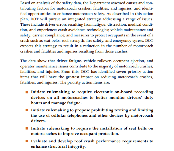

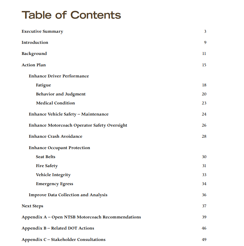

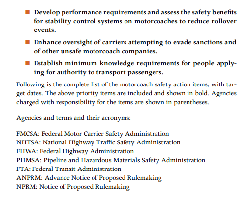

Regardez la différence!
https://www.fmcsa.dot.gov/sites/fmc...coachSafetyActionPlan_final2009report-508.pdf
Where's Canada's DOT one?
