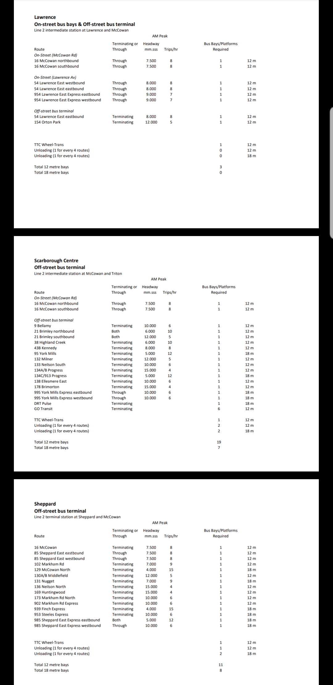

Found a proposed bus connection for the Scarborough Subway Extension in the 1488 pages technical report. (p.297)
Here is the link: http://www.metrolinx.com/en/greater...ension/04-RPT_SSE-EPR-Addendum_Appendix-B.pdf
Interesting to see is 102 Markham Rd is breaking up into 102 and 173 Markham North.
I think they planned more service east of the station than west of the station.
