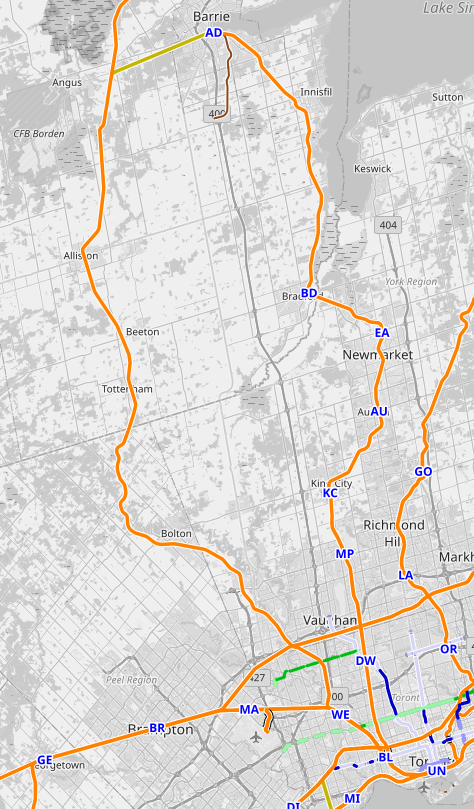

Is it feasible to see this line eventually extended there, possibly ending in Allandale Barrie?
Look at the distances involved, and how little there is north of Bolton. I don't have a mileage chart for the MacTier handy but it looks like Alliston-Bolton is a decent % of Bolton-Union.
While Bolton-Alliston is maybe 60% of Bolton-Union, it quite clearly is not that much of a longer route to Barrie overall. The way I see it is the inverse; this line could pull growth up along it, up to a level of growth comparable to everything north of Richmond Hill (suburban-exurban...), ie the Barrie corridor. Said corridor itself was not nearly so urbanized 40 years ago- GO service did not cause that suburbanization per se, but the distances involved are clearly not too great for most commuters.
I'd have to look at the Greenbelt map to know if this is actually possible or not, mostly re the ORMCP, because if there is buildable land, you best believe there will be interest in extending this line one day.

The line, and the population it would undoubtedly induce, would obviously traverse the Greenbelt. In addition, as Paul points out, there is a need to protect agricultural lands in the Alliston area. It's generally flat terrain and light soil has been highly productive for decades. The light soil made it suitable for tobacco back in the day which has now been supplanted by potatoes. As often happens, worlds collide.

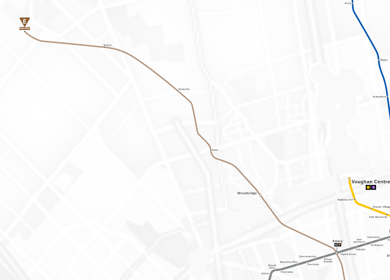

I think it would only make sense to go to Macville / Caledon Station on the Bolton line, and only during peak periods with bus services replacing the service running all stops Macville to Woodbridge then Vaughan Centre and Concord GO.

Peak-only services don’t make sense post COVID. Friendly reminder Caledon is also set to grow from 80k today to 350k by 2051. Let’s give them good transit now to help them maybe grow sustainably.

One of the most instructive things to consider when planning new heavy rail corridors is needed additional infrastructure. If you could serve Bolton with zero new infrastructure besides a station (think additional tracks), then sure, peak only service may be acceptable. If CPKC demanded a bunch of double tracking, or even 3rd tracking in some spots, then running peak only service preforms super poorly in a business casing scenario.
So TLDR, if you can run Bolton service on existing rails without new tracks, sure peak only may work. But if you’re adding lots of new infrastructure, you need TWAD.
And reminder, Metrolinx doesn’t decide what is needed, CPKC does.
