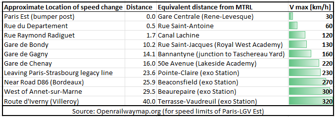

It's an urban myth that HSR depends on gaining high speed really fast. Let's have a look at the TGV Paris-Strasbourg and see how fast the speed limits actually allow it to gain its top speed:
As you can see, the Paris-Strasbourg TGV never exceeds 130 km/h before it hits the equivalent distance of the entrance to the Taschereau Yard, which is the maximum length which a Montreal downtown tunnel could plausibly bypass of the existing route and doesn't stop the TGV from covering the 439 km between Paris and Strasbourg (to compare: OTTW-BRKV-KGON-TRTO is 446 km) in 1h44, thus at an average speed of 253 km/h (i.e., well above the 180-200 km/h ALTO's own travel time targets imply).
I'm not sure what you are referring to. Obviously the travel speed through Montreal West and NDG - and from Union up the Don, are not going to be 300 km/hr (mind you, the track from Montreal West is very straight ...)
As you can see, the Paris-Strasbourg TGV never exceeds 130 km/h before it hits the equivalent distance of the entrance to the Taschereau Yard.
Yeah, it doesn't hit 130 km/hr for 10 km; but it's 120 km at only 1.7 km. I don't see that they are going to hit 120 km heading west from Central station which barely gets you to the Lachine canal. It's another 3 km of tight curves to get to the CN mainline at St. Henri.

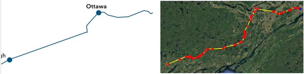

Hmm ... I wonder what happened if you stretched the drawing they released onto a proper map, at scale. It's not actually a non-schematic map is it - at least for the existing alignment sections (i.e. to scale).
Is it actually reflecting the existing parts of the alignment we expect will still be used ... say between Montreal and Ottawa ... and from Toronto up to Claremont? That dog-leg from Smiths Falls(?) to Ottawa looked odd to me - almost as if it was using some of the very old abandoned alignment up to Arnprior or something - which seems bizarre giving they already own some pretty straight track.
