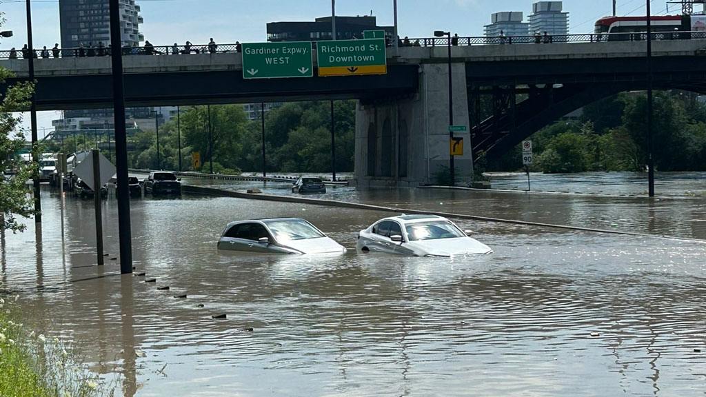

I believe this is Dundas?
That's not a spot where I think the track is prone to flooding. I believe it's a but further north, north of Gerrard, where the old CN and CP tracks are no longer adjacent.
Looking at the City of Toronto 0.5 metre topography, the ground next to the tracks is about 0.5 m to 0.75 m higher than the Gardiner. And there's the track bed too.
A little extra gravel, etc., could solve a problem there, if there is one. Look how much they've raised the track level on the Lakeshore East line from the Don to Gerrard during the ongoing upgrades.

The Don Valley floods at various spots, including train tracks, and there is no plan to eliminate that risk due to the prohibitive cost of raising the land and replacing all the bridges.

That’s the sort of thing the new spillway further south is meant to put a stop to, no?
A complete stop, 'no', a reduction in frequency, yes. The East Harbour Berm will actually increase the likelihood of flooding on the Parkway since it would keep water from spilling eastward.
But there are other projects and plans that can further reduce the risks here.
