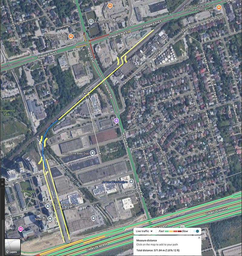

It has taken me a long time to get my head around the idea of a junction at Agincourt South(west) to connect an Alto line on the CPKC alignment to the MX Stouffville Sub.
My gut reaction all along has been, it's just too tight.... and the differences in elevation seemed vexing.
Anyways, in the end I kind of convinced myself that it is doable..... if......
The elevation of the CP line over the MX line means that Alto has to find a place to cross the CPKC line before then crossing the MX line. Otherwise, it is not possible to tie into the west track of the MX line without flat crossovers that would cause conflicts in routings. So, that means (1) a flyover east of the junction.
The most logical place for that flyover/under is east of Brimley where there are longer distances to address the necessary gradients. I can't see Scarberians wanting a flyover across the backyards of a residential area, and a flyunder would conflict with underpasses at Sheppard and Midland.
Then, going westward, Alto can situate on the south side of CPKC, curving around at the same elevation as the CPKC, with (2) one track crossing over MX before ramping down on the west side, and (3) the other ramping down to MX level on the east side.
That implies the need for two single track ramps from that point down to roughly the 401, with turnouts immediately north of the 401 overpass (otherwise, new tunnels would be needed to widen the 401 underpass). The west side is limited by large new condo towers, but the east side might offer enough room - again with (affordable) expropriation possibly needed. The gradient would be steep but potentially acceptable, depending on how tight the curve is - the gentler the curve, the less linear room for the ramp between the curve and the 401.
The question that arises is - How tight are those curves? I drew curves using a radius of 950 feet, which at 3 inch superelevation is good for 30 mph. Clearly, that encroaches on existing buildings, but the cost of expropriating those is probably reasonable in the overall Alto price tag. Maybe others can survey it a bit differently, but I would just point out that this is a pretty restrictive speed point, beyond the zone where one can say that the train has stopped at Kennedy and is not at track speed yet so no time lost (3.2 miles from the platform at Kennedy) (PS - consider flange squeal on a tight curve on an elevated ramp in the middle of a residential area - it will happen #PearsonUP)

An alternative option for the junction could be just committing to more expropriation and a longer viaduct. Expropriate a large chunk of the properties between Midland and the MX corridor to allow for a smooth elevated curve with a 450m radius. That gets you to a point just beside the MX corridor before you reach the 401. Stay elevated over the 401 and then descend to merge into the MX track just before Ellesmere where more space is available. It would be ~2km of elevated guideway based on my quick measurement, not unlike the Davenport Diamond guideway.

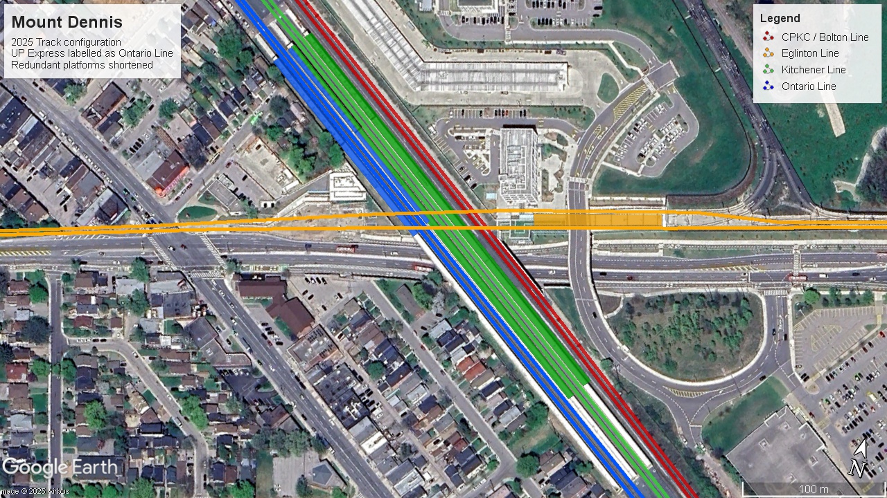

Nit picking but MacTier is not doubled through here.
Yeah I showed it as doubled since it's a future map, there's enough space and there's discussion of a Bolton GO service that would presumably be tied to capacity expansion on the CPKC lines. I figure a Bolton GO train would have one side platform at Mount Dennis on the CPKC line, directly connected to the existing northbound/westbound platform on the (future) Kitchener line express tracks.
