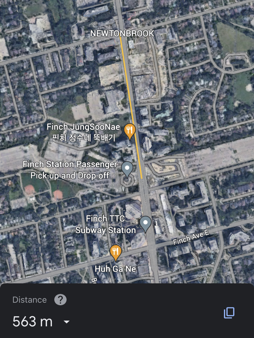

I’ve talked about why I think the merits of Cummer aren’t fully present already, but I’ll give you the gist.
1. The proximity to Finch. It’s literally walking distance to it, as Finch station is north of Finch avenue and Cummer is only ~550m away from the pick up/drop off.
It's 1.8 km from the pick up/drop off to Steeles. I don't think 900 metres (without even considering the distance from Yonge) is walking distance.
Maybe it should be at Patricia instead of Cummer. Though the thing is so deep, that you could build the headhouses near Patricia and Cummer, and have a single, very long escalator on each side into a ground-level fare line.
Still further apart than some stations.
The benefit of having a mid-block station I think is the crux of the issue here. You could justify one at a high level, but as we are discussing, the specifics don’t fully pan out. Cummer is too far south to be “mid-block” but it’s the only place you could justify one if your trying to be on a perpendicular bus line. Patricia would be decent if Cummer buses could get there easily, but It likely would have cost issues too.
Also, my measurement from Google Earth was as follows. I think we might have measured different things, but if I was wrong then I’ll concede that point, lol.

Also, my measurement from Google Earth was as follows. I think we might have measured different things, but if I was wrong then I’ll concede that point, lol. View attachment 486974
That's about what I got as a measurement. 550 metres to Cummer. Another 1250 metres to Steeles for a 1.8 km gap. But Cummer to the half-way point (about Princess) is only another 350 metres.
If you have a 150-metre platform, a 30-metre deep station, and to escalators at each then 30·3√½ = 52.0 metres. So that's 254 metres taken up by the platform and escalators.
Okay, put the middle station at Connaught then. With the north end of the platform 50 metres south of Connaught, you could go up from the escalator right to a bus terminal at Cummer. Heck, put the terminal at 5959 Yonge, and you COULD do Patricia and still have the Cummer station closer to Cummer than the Greenwood station is to Greenwood Avenue.
