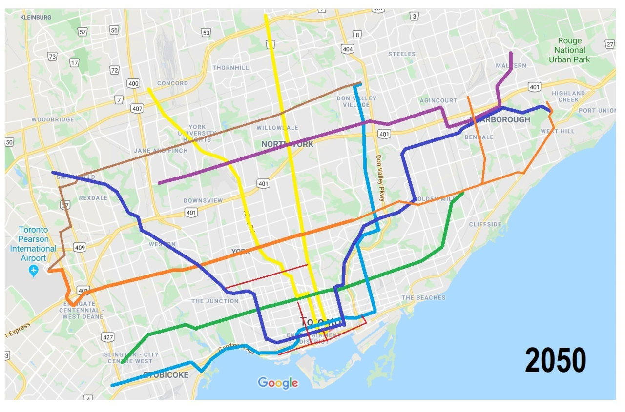

Here is an omelet breaking suggestion. It runs close enough to Yonge to be a real relief. It spaced decently to be express. It goes to Union and other downtown stations. It is building a new tunnel serving new riders
What would be bad about this line?

2050? Doug Ford can't think any further into future than June 2, 2022, the next election.
