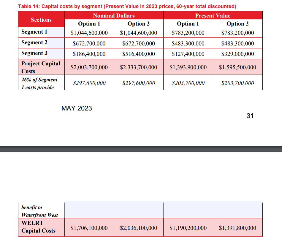

I didnt major in economics, Whats the difference between theese 2 numbers?
Present value vs nominal dollars?
Chatgpt says that if i was to prepare a report Present value is the option you should use.
If thats true then saying the project is 1.5 billion sounds a whole lot better
also thats where 2.5 bil comes from theres about 200 mil spent on planning and design to this point and in the future
Note that 300/200 million of this project lowers the cost of the waterfront west to long branch because of the portals
I think nominal dollars is projecting inflation into the future and what the cost would be after projected future inflation in the year the expense will be incurred
