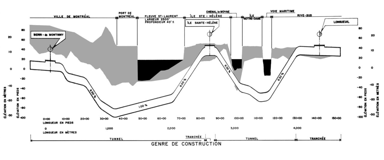

For reference, AFAIK, the max slope in the Metro network is 6.3%, between Jean-Drapeau and Longueuil
Awesome, thanks - raw data is always best :) Looks like the final answer on the subject is that steel-wheel trains could not have been used when the system was created, but that there are apparently some modern ones that could now handle the steepest grades in Montreal's system. Maybe, way down the road, that could open up options for MTL.
Ah, maybe that elevation map explains why there is no yellow-line station in Old Port. From this, I would guestimate that the tunnel doesn't get reasonable flat until north of Viger.
