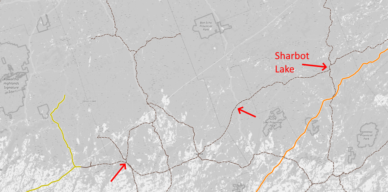

At first I thought they were proposing a bypass from the original Havelock Sub somewhere between Havelock and east of Sharbot Lake? The map is very pixilated so it's hard to tell. When I looked at Open Railway Map it turns out it looks like they are following this corridor. Surely there would have to be some straightening if they wanted to achieve "Red: 200-300 km/h"? cc @reaperexpress @Urban Sky [I think you've done some mapping/calculations here before]
Black arrows annotated below for the 'dip' between Bonarlaw Junction (east of Havelock) and Sharbot Lake.
Red arrows annotated below for the 'dip' between Bonarlaw Junction (east of Havelock) and Sharbot Lake.

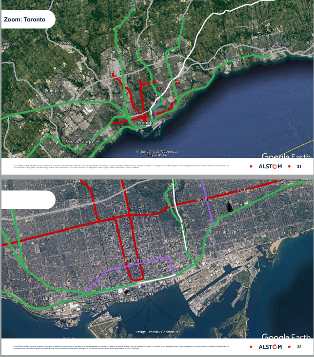

Also, looks like they are proposing to use the Don Spur to get into/out of Union Station rather that the LSE-Stouffville Line-Belleview Sub. I guess we'll know in a few months (years?) when the public consultation/document release process advances? I wonder what this may mean for GO's Don Valley Layover.
